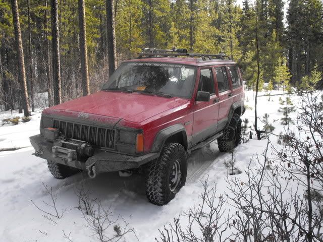

Here it is as a nice little baby the day I brought it home. The guy I bout it off almost did not sell it to me. He asks me what I wanted it for. I responded to drive and go camping in. He goes good I don’t want it chopped up and bush beat.
The next day RE 3.5 and 31” Pro-Comp Extreme MTs ;D
Later that day. I had to :eek:
Radio for com’s
Next to carry the spare and high lift a roof rack made from material I scavenged from scrap metal at work. It was funny how all the pieces where found in the bin and where the perfect size and length already.
I was not going to go with a bumper and winch right away, but the deal of a century came up so I could not refuse.
Waytec
After a meeting with a log
Sliders where in order
I found having the spar on the roof made the rig to tipsy. A swing out is not in the budget right now so, inside the spare goes on it own rack.
Stay tuned next is an on board air system and I have bent my front stock track bar so a heavier one is on order.

The system is set up that I throw the switch in the cab green light comes on to remind me that the pump is on. The pump starts pumping. Once it the pressure in the tanks gets to 130psi the pressure control cuts the pump out. Once the tanks get down to 100psi the pump will cut back in. I figure I should be able to run a ½ inch impact off this in short bursts.

The Orange paper in the window is an Out of Bounds Pass. I am part of a group that is scouting and mapping arias for new trails in this OHV aria. :wings:
The orange card tells the people patrolling by helicopter that we are allowed to be their.

SRD the trail cops. If they find you off trail by chopper they will then come to you and they like to start with the $300 off trail fine and then keep adding as they find things. :Wow1:
