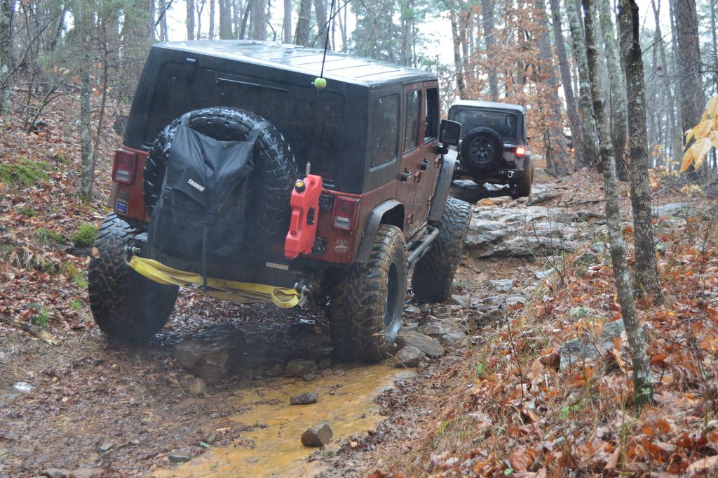

I found that when I'm loaded heavy the rear door would rub on the metal bumper (XRC), so I added a 1.25" BL to overcome that. Ended up removing the bumper and going with the EVO bumper delete.

Bumper delete:
