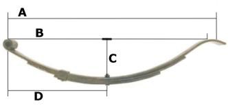

So I'm about to order all the trailer parts from red neck trailer supplys and debating on using there 24" leaf springs or not. Seems like a few members here have mentioned using a single main leaf spring along with air bags instead of the stiff 24" standard leaf springs.
Problem is I haven't actually seen any threads in my search of anyone actually doing this. So if anyone knows any, please give me a link. All I really need to know is what would be a good leaf spring to use? The dimensions of the leaf need to work for the application. Look at this image: Measurement C is what I'm concerned about: https://www.etrailer.com/static/images/pics/q/u/qu62403_800.jpg
The leaf spring hangars will be mounted on the main 2x3 side frame rails and the leaf will need to have enough arc (measurement C) to fit a 6781 firestone ride rite air bag inbetween the leaf/axle mount and the 2x3 frame rail.
Another Q: If I can find the right leaf to use, and I have it mounted like such, Do I need a bump stop somewhere?? or is the air bag meant to handle bottom outs???
