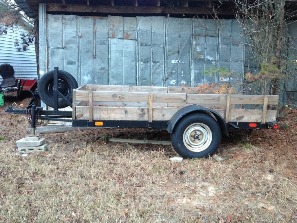

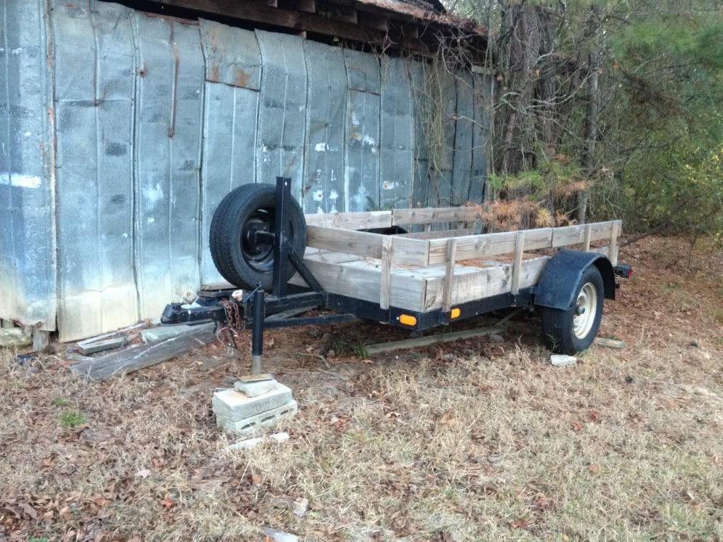

Hello from the Granite Capitol of The World,
Homemade 5'x10' flatbed utility trailer. Made by my grandfather to haul smaller loads of granite monuments years ago. For the ones that do not know what they are they are head stones, but most of the time larger. A monument usually weighs between 500-3000 lbs. So the trailer's main frame is built out of 2"x3" .250" wall channel while the 5 crossmembers are 2"x3" .250" wall channel. Axle is a narrowed 3500lbs, 5"x5" bolt pattern on chevy ralleys. The spare tire mount, I added mainly for a anchor point to use an come a long to pull up scrap metal. And this trailer is HEAVY it is seriously probably pushing 900lbs by it self. I am just curious to know what it would take for this thing to be a decent Expedition Trailer??

I don't know about what you could build up on it (I guess whatever your pocket book and imagination will bare), but just the shear fact you Grandfather made it, makes it pretty much priceless in my book.
Have fun with it and good luck,
Pat
Mark Harley
I agree, A tear drop trailer build or make an elevated rack and keep toys under.
RTT on top quad, bikes, water toys.................
Axle flip for added height and maybe a bob on the rear to remove a little length.

I didnt think about the kayak and MTB being transported on the trailer. This thing could no means be a trailer you take to the rocks due the rocks but for what my truck it can do its perfect. Is there any way to put longer leaf springs under it for a little more flex?
