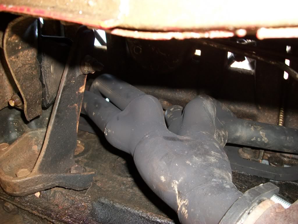

So i've been avoiding driving my Xj because of this:
So I orderd the APN header monday Night, It was on my door step friday morning. I cleaned & painted it with VHT Flame proof stuff :
I started the install Sat at 11:30am and was driving the jeep by 5:00pm, I removed the rad and header panel for extra room during the install.
I could not be happier, The sound is great and that header is beefy !!!

Can you shoot me a PM on where you purchased the header?
Also, did you check your motor/trans mounts? Been told their the leading cause of header cracking. (I'll be doing mine in a few weeks :() I'm glad to hear it was a somewhat easy task.
BEVAN
Yep, I replaced the motor mounts with OE ones from jeep and a trans mount from NAPA... There was no rubber left in the driver side !!
I picked up the header from :
http://www.ineedparts.com/index.php?target=products&product_id=15343
