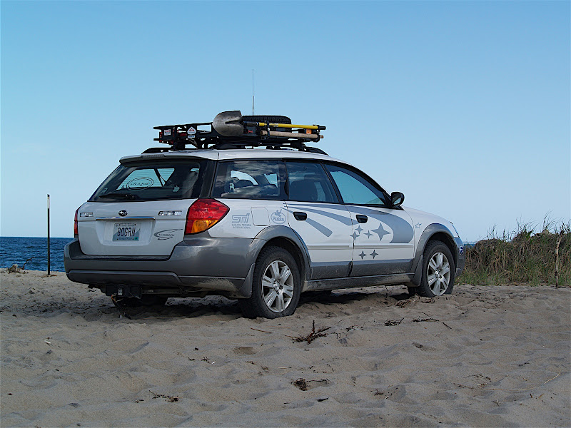

We spend a lot of time in the summer at a local beach that's accessible only with 4WD down a 4 mile sand trail. Self recovery is a necessity as the cost to be pulled out by the state approved contractor is $700! :Wow1:
We also carry a land anchor on these trips since the ruts can get pretty deep late in the season and the ladders may not always get you out, but the winch (Black Rat, Warn or Hi-Lift jack depending on how much time you have to kill) will get you out of most anything when attached to the Pull-Pal land anchor!
