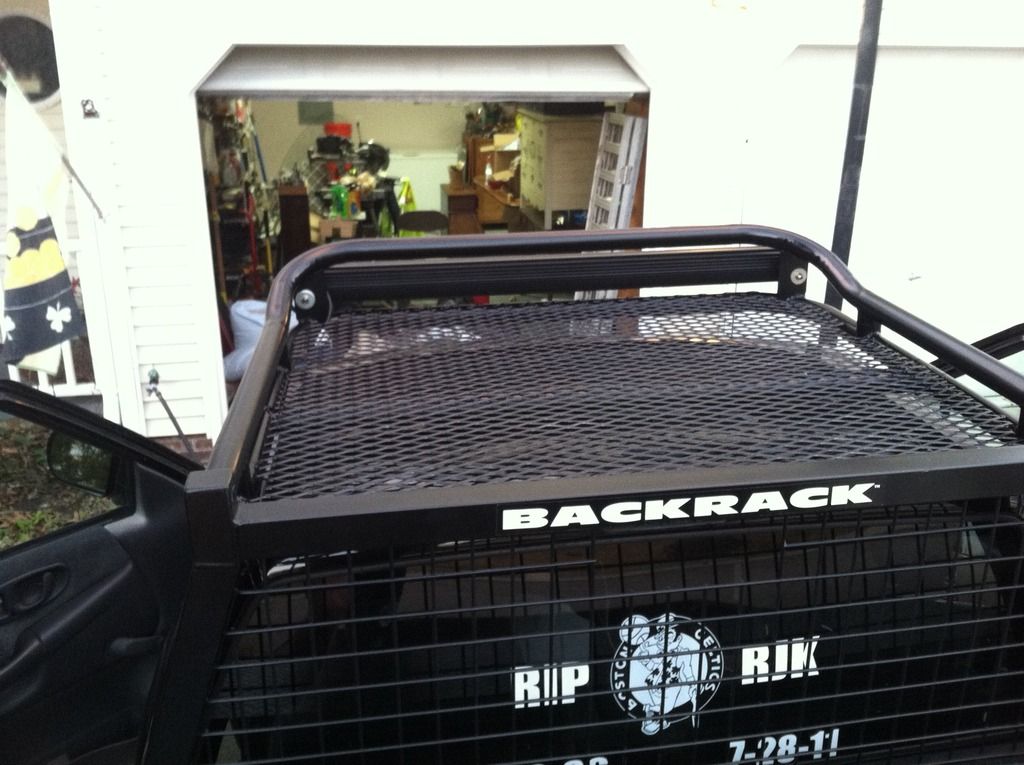

I have a 42" cheapo Chinese led light bar (brand: newcomdigi/eyourlife if you're wondering) that I have on a custom roof rack built off of a Backrack brand headache rack. Had the light bar for about 3 years now and it's never let me down (knock on wood lol) and had the roofrack for a little over a year now. *ive never posted pics on here so I'm just doing it the way I'm used to on other forums. If it doesn't show up correctly my apologies*
