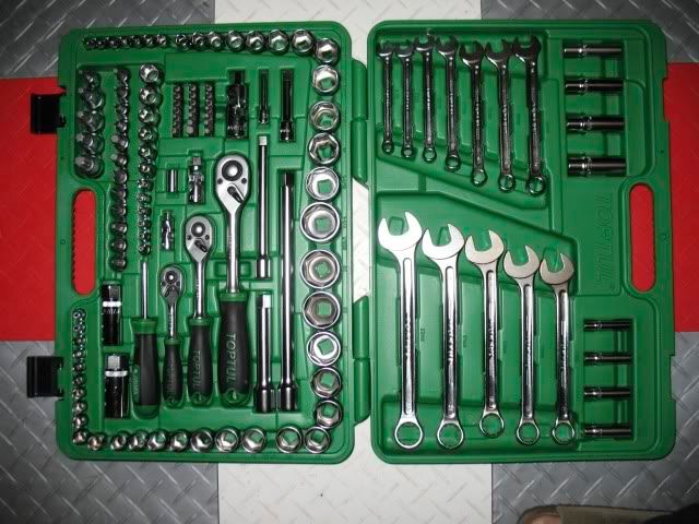

Anyways this is what I wrote:
Just going by memory:
Tool set (sockets, open ends wrenches..metric-standard) by Toptul
http://www.wrenhandtools.com/index.html
130 pcs 1/4, 3/8 & 1/2 drives
They no longer stock this very complete set, but they maybe able to still order it, if you call him.
