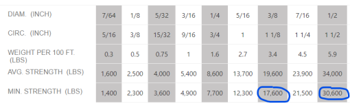

Below is minimum strength of Amsteel Blue, which is often the basis of many synthetic winch lines.
Winches are only capable of their rated capacity on their first layer of wrap - it goes down after that. Warn 16.5 lb winches that come from the factor with synthetic line use 3/8", so that is what I would choose.
Bubba Rope, Factor 55, customsplice.com, and Master Pull might be worth considering. It is way cheaper to just buy the synthetic line and splice your own ends if you like the DIY approach. As a winch line can be potentially lethal, make sure you are dealing with a reputable place and getting what you pay for. Marine, arborist, and rigging supply companies are alternatives to 4x4 shops, as synthetic rope has been used in these industries longer than on 4x4s.
Here is another thread on the topic.
Those are minimum BREAK strength. NOT working load limit strength numbers.
I for one, would not place much faith on 3/8 working reliably on a 15k+ winch, considering its working load limit is just 4400lbs
Generally, 7/16 synthetic is considered standard for 10k - 15k winches.
Beyond that, Id look into 1/2"

The off-road recovery industry does not have any standardization when it comes to rating equipment. Most winch lines, snatch straps, etc. will be advertised at their breaking strength. Shackles, however, are often advertised at their working load limit (working load limit = breaking strength / safety factor). Working load limits are more common in overhead lifting situations.
The most important thing is that you know at what points various parts of your recovery system will break, and then design in your own safety factors. 3/8" is a bit borderline for a 16,500 lb winch. Keep in mind that you lose about 15% capacity for every layer of rope, so your 16.5ti probably has about 14,000 lbs capacity on layer 2, 12,000 lbs on layer 3, etc. Also the specs I circled in Post #3 are the minimum breaking strengths, the average breaking strengths are about 10% higher. 7/16" rope would give you a bit of safety margin vs. 3/8", while not being that much more expensive.
