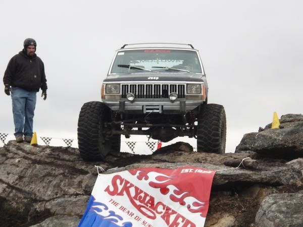

I have this Warrior bumper:
I saw this:
I'd like to put a winch behind my bumper...
I know that some sort of sub frame mount/tie in would have to be fab-ed up.
What do you all think?
I know any thing is possible, but do you think it would be practical/cost effective? I would have to have some one fab it for me...
Pros? Cons?
Many Thanks

It seems like what you want should be pretty do-able. The nice thing is that the winch doesn't have to actually be attached to the bumper. All you need is a mounting plate that spans between the frame rails. Cut a hole in the bumper for the cable, and mount a nice roller fairlead on front.
Winch mounts seem to be pretty standardized: most of the ones I've seen need four bolt holes in a 4.5" x 10" rectangle. You can probably mock this up with a piece of cardboard, and figure out whether you need some kind of brackets, or if you can bolt the mount directly to the frame rails. (I'd use some beefy angle iron for brackets just to spread the load.) If it were me, I'd try to mount the plate from underneath. That way, when you need to service the winch, you can just drop the whole plate/winch assembly, instead of having to yank off the bumper.
The tricky part will be finding a winch that will fit in the space available. From your picture, it doesn't look like there's a lot of room vertically, nor a lot of space between your bumper and your radiator. You'll probably want to look at some low-profile winches (maybe a Ramsey rep8000?) or one with remote solenoids.
One issue you'll have to be careful of: with the winch hidden, you can't see how the cable is winding onto the drum. If you're doing a hard side-pull, the cable may build up on one side instead of laying nicely across the drum. This can pop the winch's tie-bars. But, it's certainly manageable, just do straightish pulls or assign a helper to watch the drum for you.
proto
Hmm. . . that's a different approach! The XJ bumpers I see always have long brackets (like maybe a foot long or more) that reach back along the frame rails.
This mount looks like it spreads the loads over the front stamped-steel box section of the subframe. (I wonder if that's sufficient?) It's definitely not something one could duplicate with just hand tools, though.
In any event, it looks like there's enough room to squeeze the right winch in there behind that bumper. (Is that Warn XD9000?)
