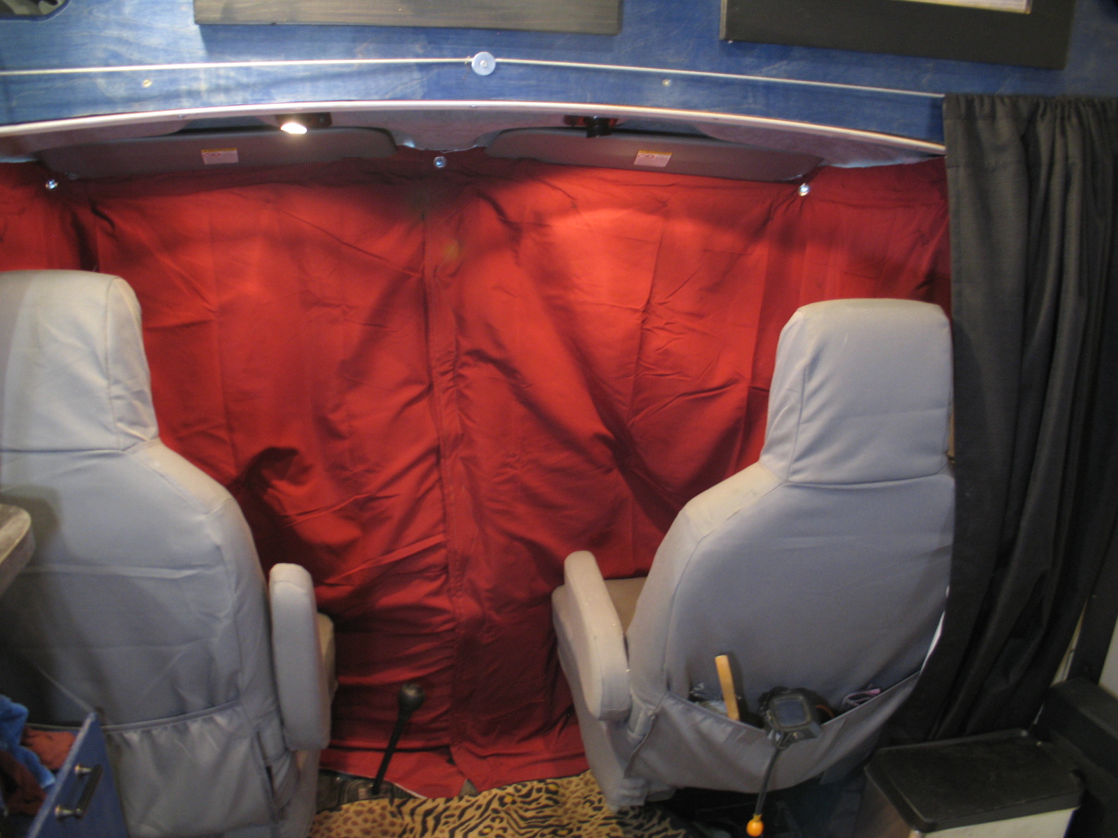

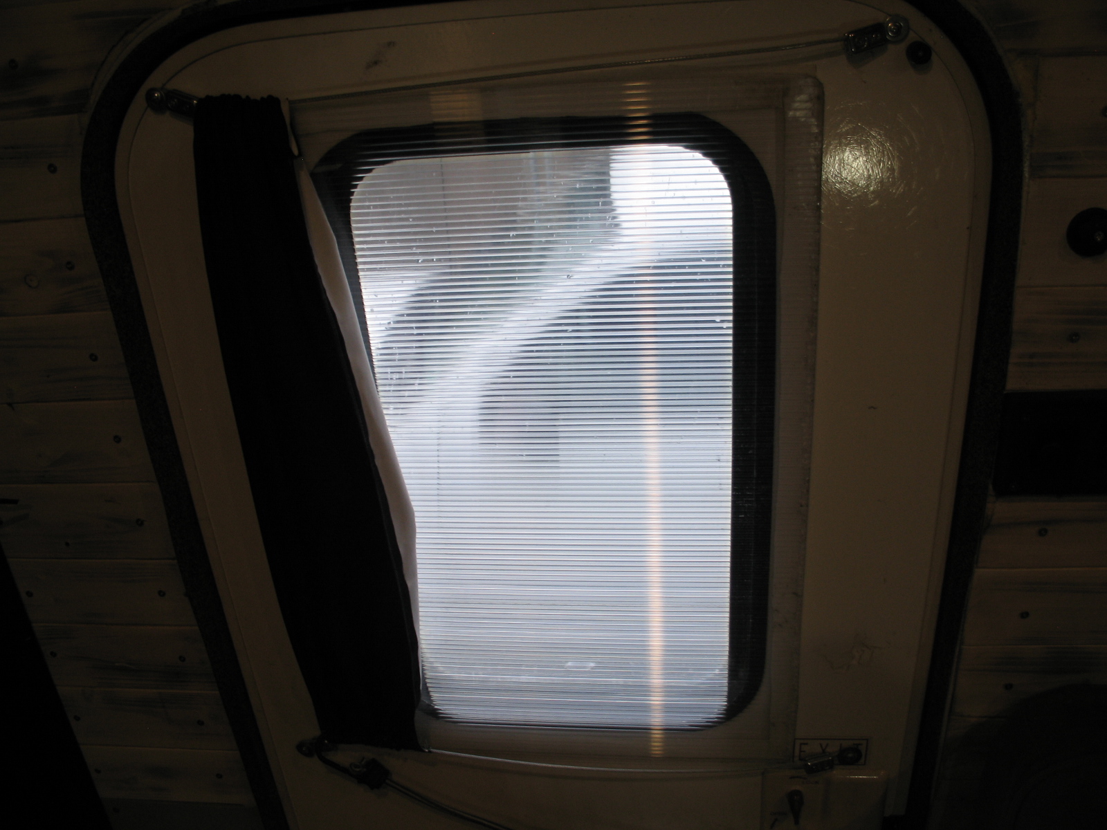

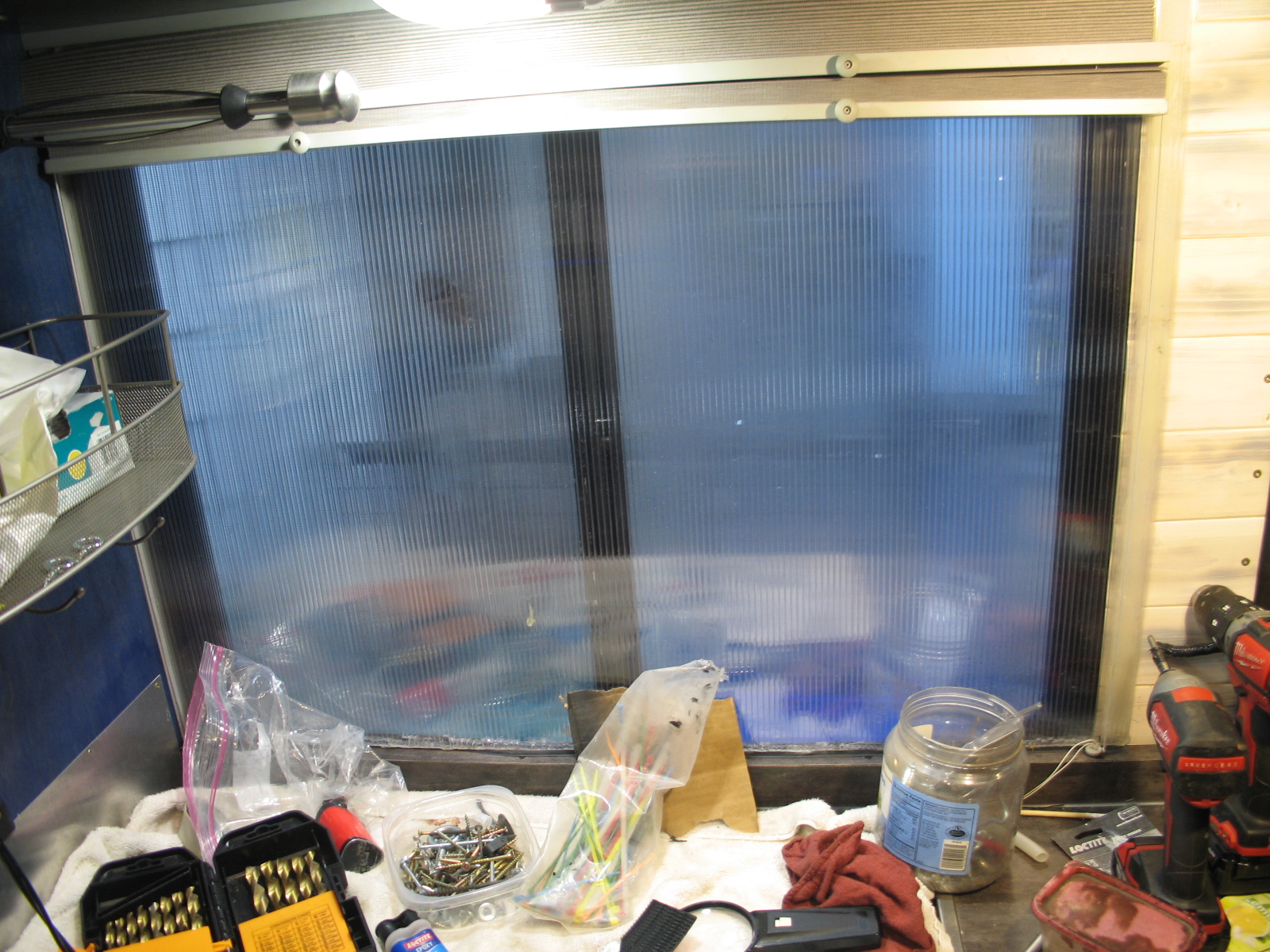

Easiest to just get a Truck Camper like Arctic Fox, Lance, Host or similar. Either way its a tall order if you are on a budget. Be prepared to throw a lot of fossil fuels at it to keep it warm and unfrozen. Skirting and thermal curtains go a long way. I made my own dual pane windows using multi-wall poly carbonate. The red curtains have 80g Thinsulate sandwiched between the plies with Mylar foil.
I spent 2 years researching before buying a custom built rig. Wool insulation inside a fiberglass clam shell with all plumbing inside the cavity. Good down below 0˚ but the floor is chilly (Down Booties !)
