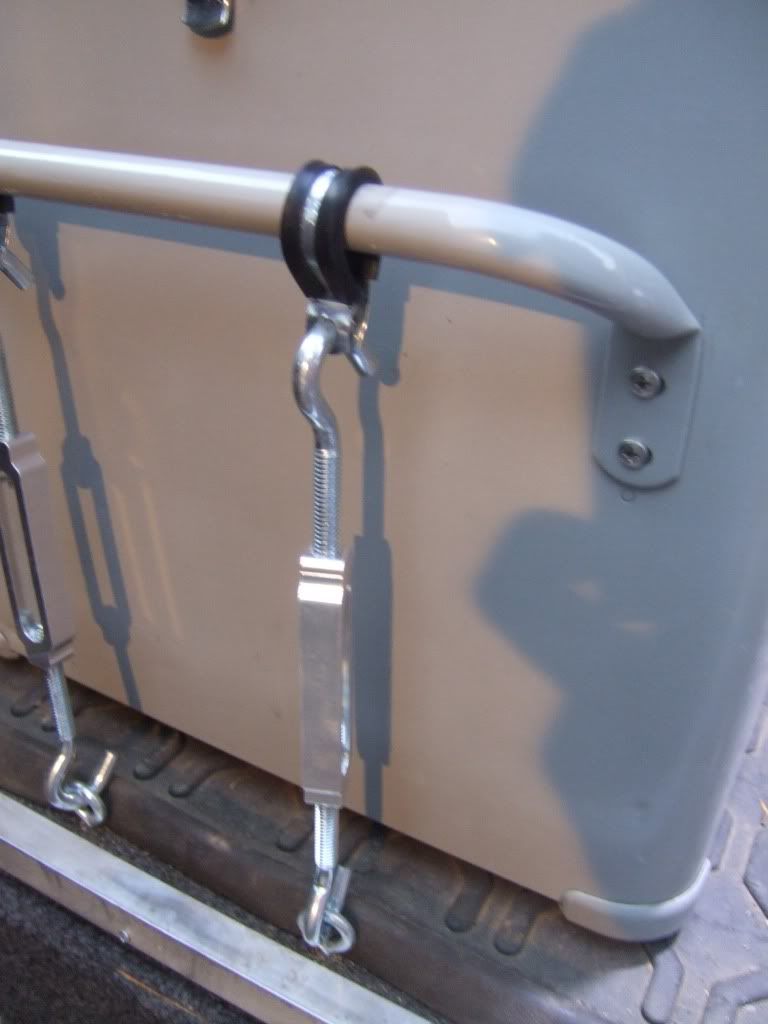

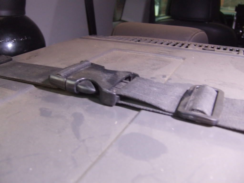

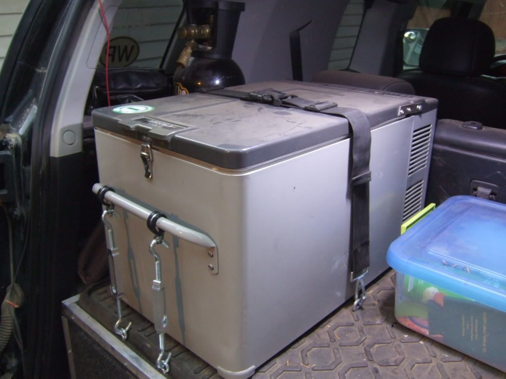

You could try this. I have the same fridge and this set up has worked really well for me for the past year. I do not have the handle installed in the back, won't fit with the seat back upright. But it really is quite secure...cost for materials is maybe 20 bucks, and 30 minutes of your time. Obviously you have to unbuckle the strap over the top to access the fridge, but it takes all of one second, no big deal.

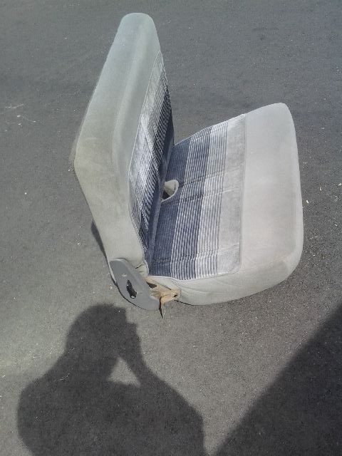

..I am thinking about taking out one of the back seats, customizing something in it's place for the fridge, but it still needs to be secured..
..I do like the strap over the top with the quick release...That strap adds some security over the latch being the only thing keeping the lid secured and the contents of the fridge from coming out in a rollover..:cool:

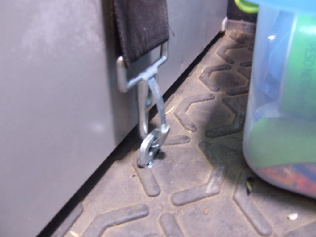

You have a keen eye. The strap is in fact from a Trasharoo, after the zipper decided to self-destruct. But it was graciously replaced by Wil at Sierra Expeditions, with Dave's (from Trasharoo) blessing. But it's easy to make your own fridge tiedown.
Buckle:
http://www.rei.com/product/612226/rei-trovato-dual-side-release-buckle-20-inch-wide
Webbing:
http://www.ebay.com/itm/2-inch-Webb...195?pt=LH_DefaultDomain_2&hash=item2c68452dcb
(I know REI used to sell this as well, but I couldn't find the 2" webbing on their site. Might be able to find it at a craft store as well. I just cut it to a custom length and had my girlfriend sew the ends to prevent fraying.)
Clamps:
http://www.amazon.com/KMC-Stampings...&qid=1348415892&sr=8-10&keywords=rubber+clamp
Should be able to get these at most any hardware store, I got them at Ace for about a buck a piece.
Turnbuckle:
http://www.amazon.com/TURNBUCKLE-ST...F8&qid=1348416108&sr=1-10&keywords=turnbuckle
Also available at any hardware store, a few bucks a piece at Ace.
Eyehooks:
http://www.amazon.com/Lehigh-7229-6...e=UTF8&qid=1348416227&sr=8-4&keywords=eyehook
Again, hardware store. (Ace's website sucks. Love the store though.)
Anchor tiedown:
http://www.amazon.com/330004-Degree...&qid=1348416425&sr=1-1&keywords=swivel+d-ring
Something similar to this. Mine aren't recessed, and there are lots of styles to choose from.
Clips:
Couldn't find a link for the clips on the webbing that attach to the anchor tiedown, but again, hardware store. Should be pretty easy. I too thought about removing a seat...but this seems to work just fine for now. Biggest things to consider are making sure the turnbuckles fit through the clamps, and make sure they are the right length between the clamps and eyehooks. Good luck!!
