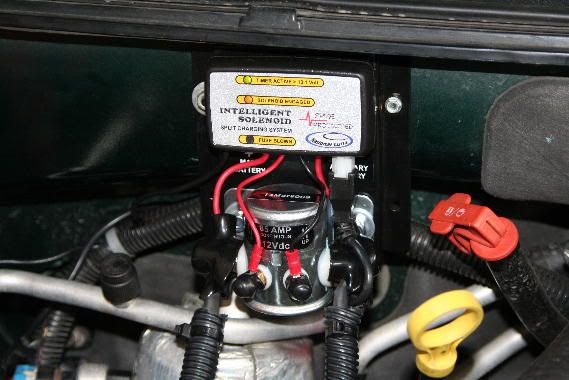

My National Luna install
I just got done installing my National Luna DIY Dual Battery setup on Monday. I got my kit from Sierra Expeditions. Pics of the install on my 2002 Chevy Tahoe, which had only one battery before last week -
And here is one of the remote control " in action "
The kit is easy to install, I spent more time trying to figure out where to hide the wires than the actual work of assembling it. Only observations: my install location is very tight for clearances with the hood and bracing brackets. So I ended up using battery terminals I got from Salvo Auto Parts instead of the ones with the kit. The ones with the kit have multiple bolts for tapping in accessories and they posed a potential for shorting the system. The Salvo terminals were lower profile, and enabled me to use the protective "boots" that I put on top.
Also, you will need some heat shrink tubing to clean up the clamp on connectors at the solenoid and fuse relays. Both housings allowed "bare" positive segments of the system to be exposed, which is a no-no for me. No biggie, all my stuff gets heat shrinked in my truck but it would have been nice if NL included it with the kit.
Other than those two very minor points, I love the kit. Very easy to put in.
