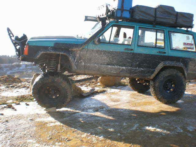

cnskate
I was about to commission a custom lower roof rack than my Yakima for my RTT, but that Thule looks pretty low. How many inches off the roof is it? Why 4 of them? 2 Yakima's have been fine for me so far.

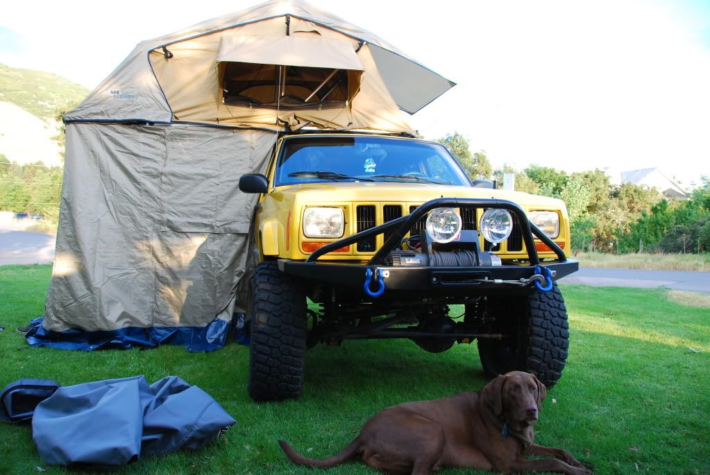

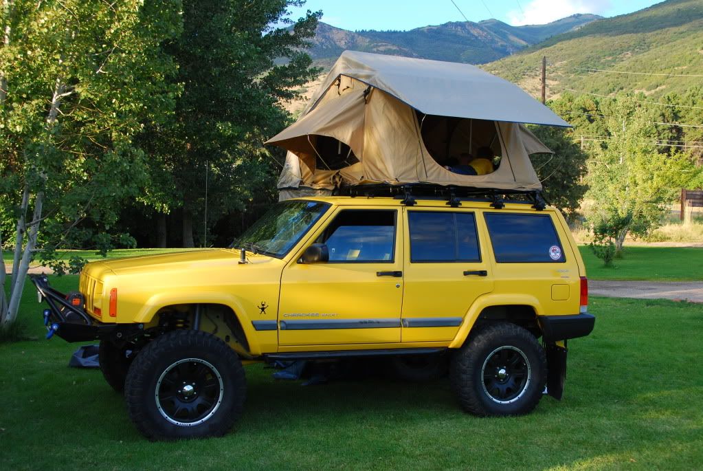

DrMoab
Decided to go with 4 bars and I'm glad I spent the extra money.
BTW that tent is sexy, can't wait for next weekend!!!
Maximus Ram
Nice set-up..:safari-rig:
That thing sure is Yellow...guess you will always be able to be seen:Wow1::sombrero::26_7_2:
