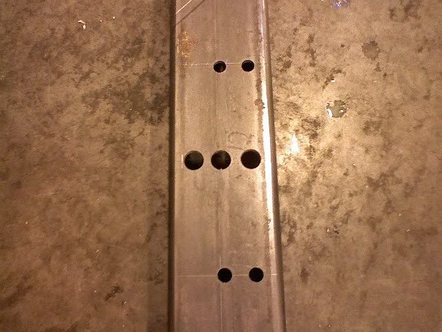

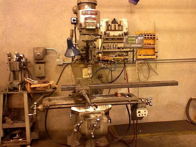

The Bumper started as a peice of 2x4x3/16 and will sit flush against the Jeep rear crossmember. I milled bolt holes on the back side were a nut strip will be welded in side the bumper before putting on the end caps.

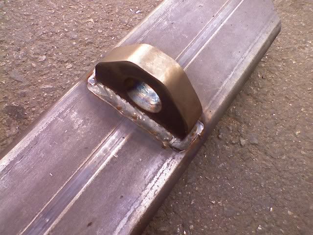

I also milled three 3/4" holes so that I could plug weld the back side of the clevis mount to the back of the 2x4. Clevis mounts are 3/4" stock and should be strong enough.

I love my Mill and Lathe for projects on my truck. Its not exactly the Bridgeport you have, but it works! Nice start on the bumper!

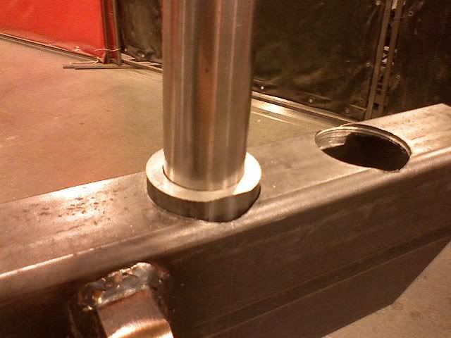

Clevis mounts are finished and welded in.

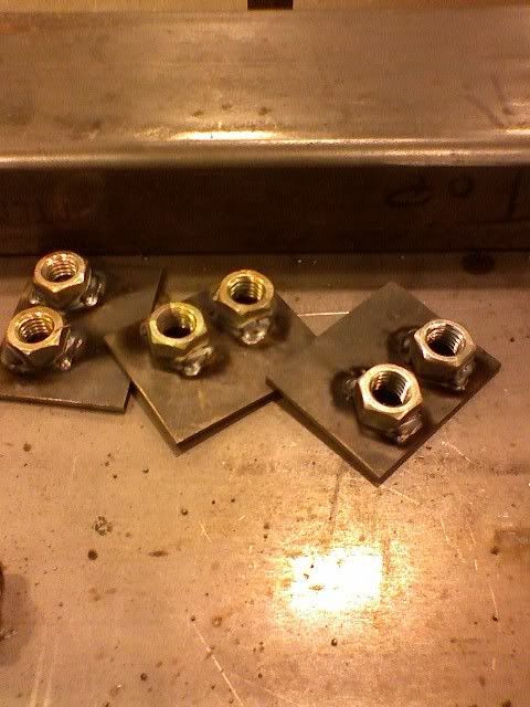

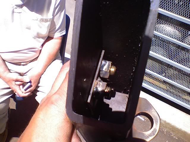

And because I'm bolting the bumper directly to the rear crossmember I had to create a nut strip and weld it inside the bumper.
I then machined a spot on the bumper to locate the swing arm pin. There are 2 holes because I change my mind after I drilled the hole on the right. OOOPS
Any ways I weld it back and now no hole.

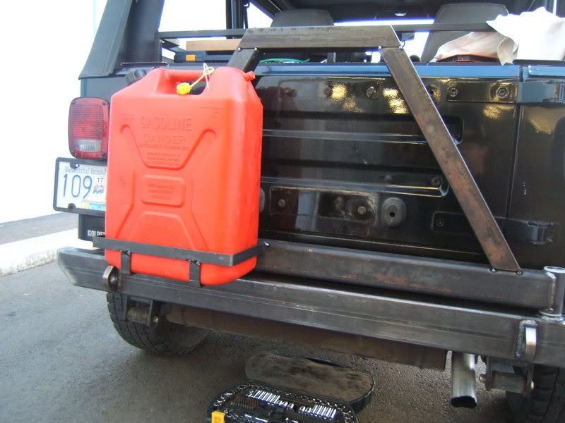

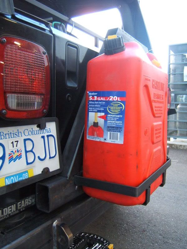

One big issue I had to deal with was how to mount my jerry cans.
I was going to use the Blitz mounting system but, they look bulky and don't hold the plastic cans so well so I came up with this.
There will be a strap that holds the jerry can in place.
And with the first jerry can in place.
