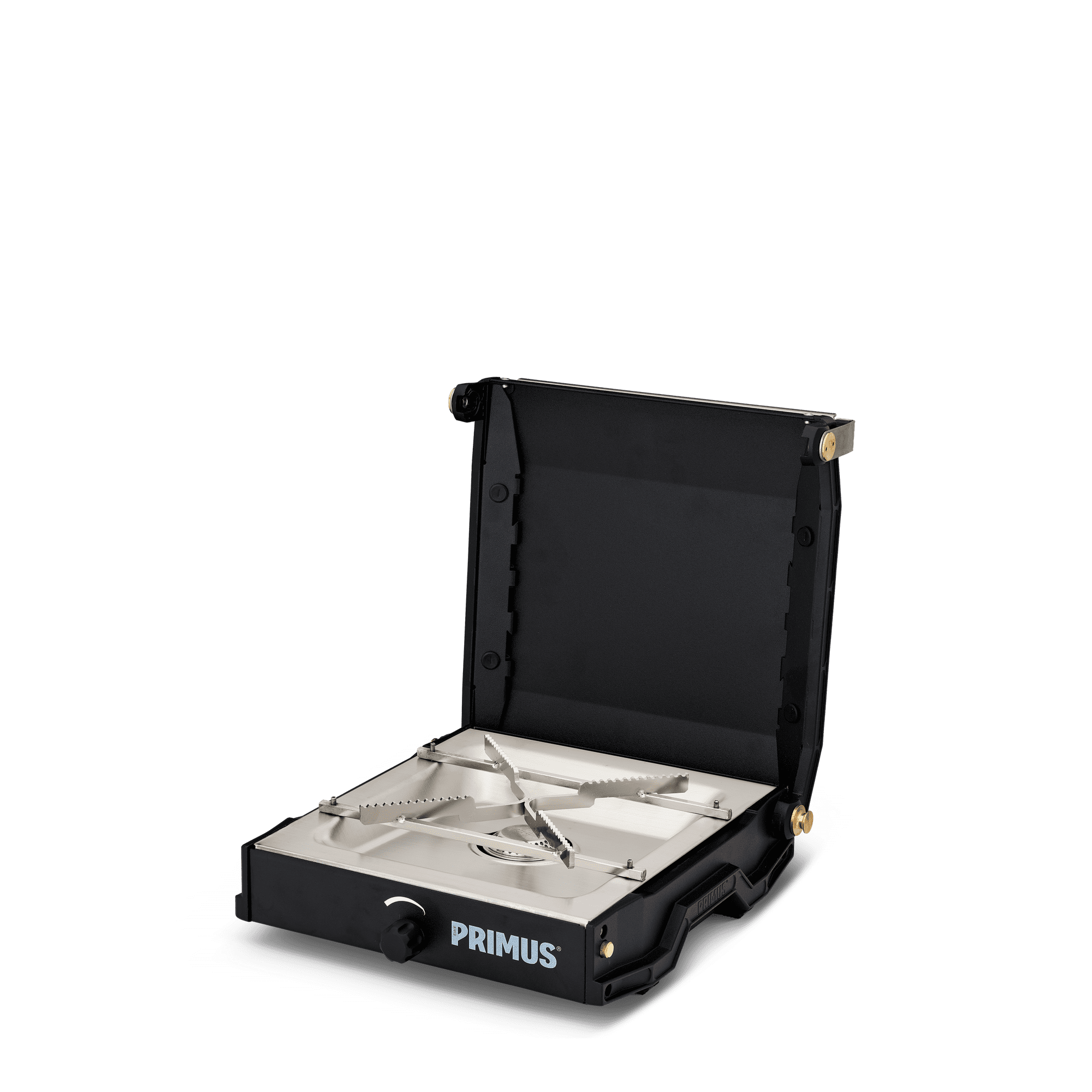

Looking for the same. This one also caught my attention, although certainly not inexpensive.
shays4me
Willing Wanderer
I was looking at the same one. I haven't looked at it in person though so I'm not sure how heavy duty it is. I almost pulled the trigger one day when it was on sale but I do not want to be the guinea pig on this! The only thing that immediately turned me off is the lack of an igniter. That's not a huge deal but it should be included for the price. Jetboil has one that shows some promise too called the half gen.
NVLOC
I agree, the Primus looks a bit more Ikea than i'd like - a bit dinky all around.
