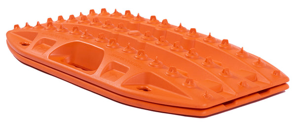

They would’ve been helpful here for sure for ease of use, but I would imagine the full size ones floated on the sand better? They definitely flexed a lot. Maybe the small ones are stiffer?
They are much stiffer. I have the Mini and so-called JaxBase combo. It’s one mini and the second is reinforced with a footprint space in the middle to fit the bae of a jack (will fit a bottle, Toyota, or HiLift and I assume an ARB too). The jaxBase is cross gridded on the back and super rigid.
Yes the full MaxTrax float better on sand — for sticking under tires to get out, but they flex a whole lot and aren’t as good support for a jack, and IMO for bridging. I really like having two full sized and the Mini/jaxBase combo. In the the three years I’ve been in the Tundra I have never used the full sized though. I have used the Minis multiple times for various things though. Plus, the mini’s can be placed under a full size to rigidify it.
Also: The point has sort of been made earlier by me and others, but I’m just gonna point out again that no non-HiLift jack (and to a lesser degree the ARB and the Tauler) is going to be able to help us recover a rig that has slid off a rock or a steep edge of a trail or road where there’s only sloped ground or rocks and the wheel has to be lifted ( or the whole vehicle) to get something under the tire to get you going again. Of course you have to have lift points, but even a wheel can be. Definitely not the same circumstance as the OP’s dilemma, but has to be be considered in picking the right combo of jacks for the conditions and expected/possible needs.
