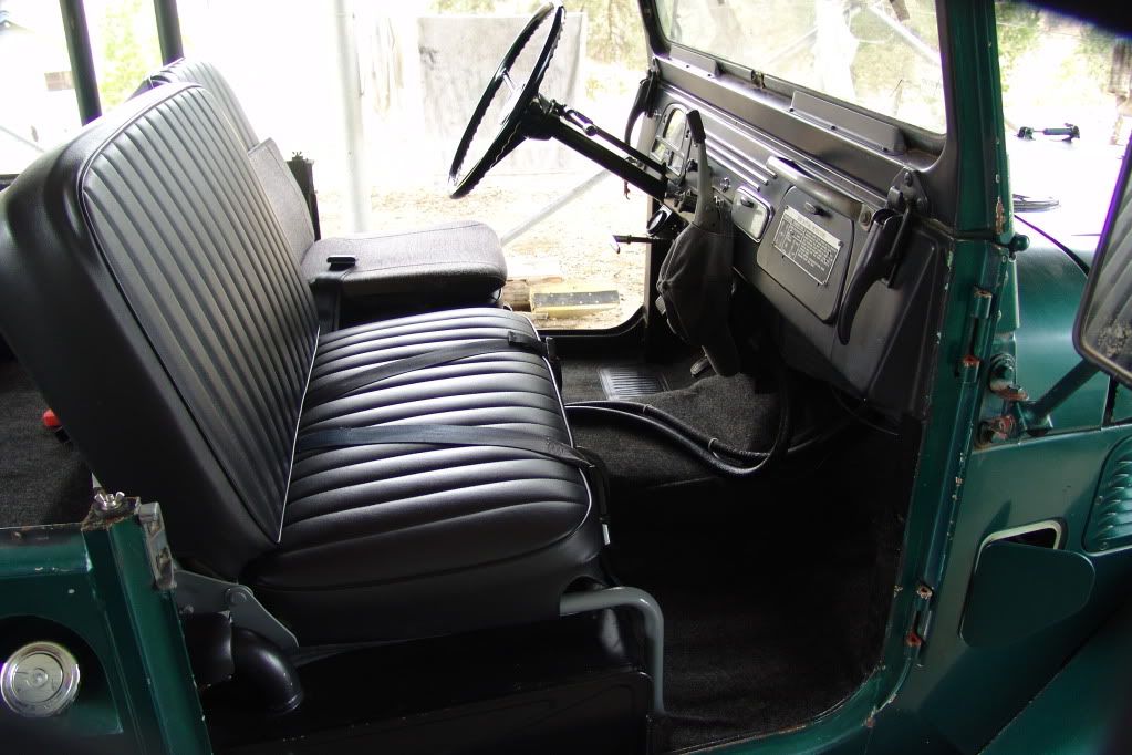

Well, here goes. I bought this 1967 FJ40 in 2003 in stock condition. Initial mods are were to take out the VW seats and replace with the correct stock bench seats from Specter Off road with new covers and foam.

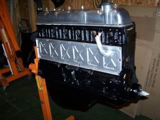

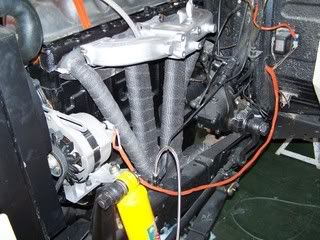

The original F engine came out and a rebuilt forklift Toyota F engine went in. I drove it like this for 5 years when I burned an intake valve and decide to replace the F with a 1973 F.5 or Transition engine. The refirb grew out of the engine swap.

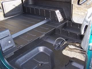

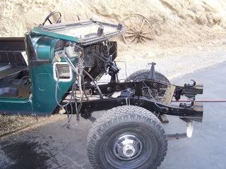

I pulled the drivetrain (3 spd trans and transfer case), rebuilt the F.5 and cleaned and painted the frame. The vehicle had very little rust so that didn't occupy too much of my time. The interior of the tub was stripped, primed and coated with Durabak.
