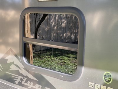

Anyone know any windows, preferably frameless, that I can swap into place of the windows found on my ‘23 Intech Flyer Chase?

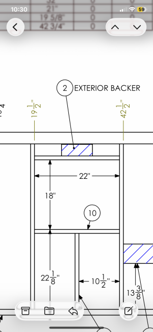

I contacted Intech after I noticed the ‘26 lineup has frameless windows that open up more that would provide better ventilation and coverage during some small showers. They mentioned that they could not offer me a replacement other than what came on my trailer and did not have any other options for me. As seen in the prints I acquired from them, my trailer window openings are 22” x 18”.

A window is not much different from a wheel - find one of the right size and you're in business.
In your case, the right size is 22x18. When buying a replacement ensure that the trim kit it comes with is compatible with the wall thickness in your trailer. Outside of that, there's really not much to it. Have some butyl tape and sealants on hand, and go at it. Simply bolt-off, bolt-on the replacement.

Unfortunately I cannot find any frameless or tilt out window like you posted with the dimensions I have. That’s why I was hoping Intech could have offered some insight as to how to get the ones the ‘26 come with.
