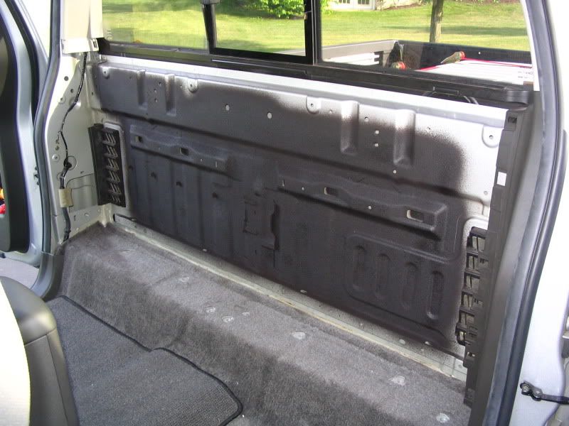

On Saturday I cut off the bracket that holds the stock jack and jack tools, then sprayed the back wall (avoiding my mounting points) with sound deadener. I did not do this to make the truck any quieter, I only did it to not make the truck any louder, as the stock plastic that I am replacing had some foam mat of the back to reduce sound.

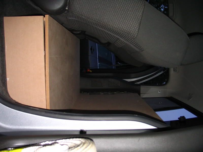

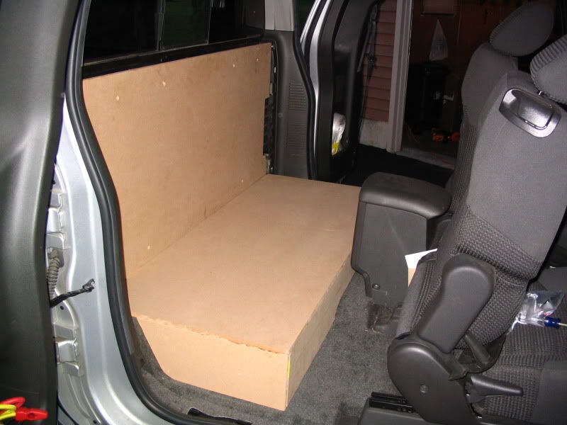

Today I did all the main wood working. It is all 1/2" MDF. I still have to cut the 2 doors that will be in the floor on either side, finish up a couple details, glue/screw and carpet everything.
It is built so that the platform just clears with the seats all the way back (how I always have them) and reclined at whatever angle you want.
I know some of you would have done it with some curves and stuff to make it look nicer, but I wanted it to be as utilitarian as possible to make it as easy as possible to store lots of stuff like coolers, my action packer, etc.
Here are the pics:
That gap isnt poor workmanship, its just because its not glued together yet.
Try fitting a 35gal. Action Packer in your KC without this mod! IMPOSSIBLE!
