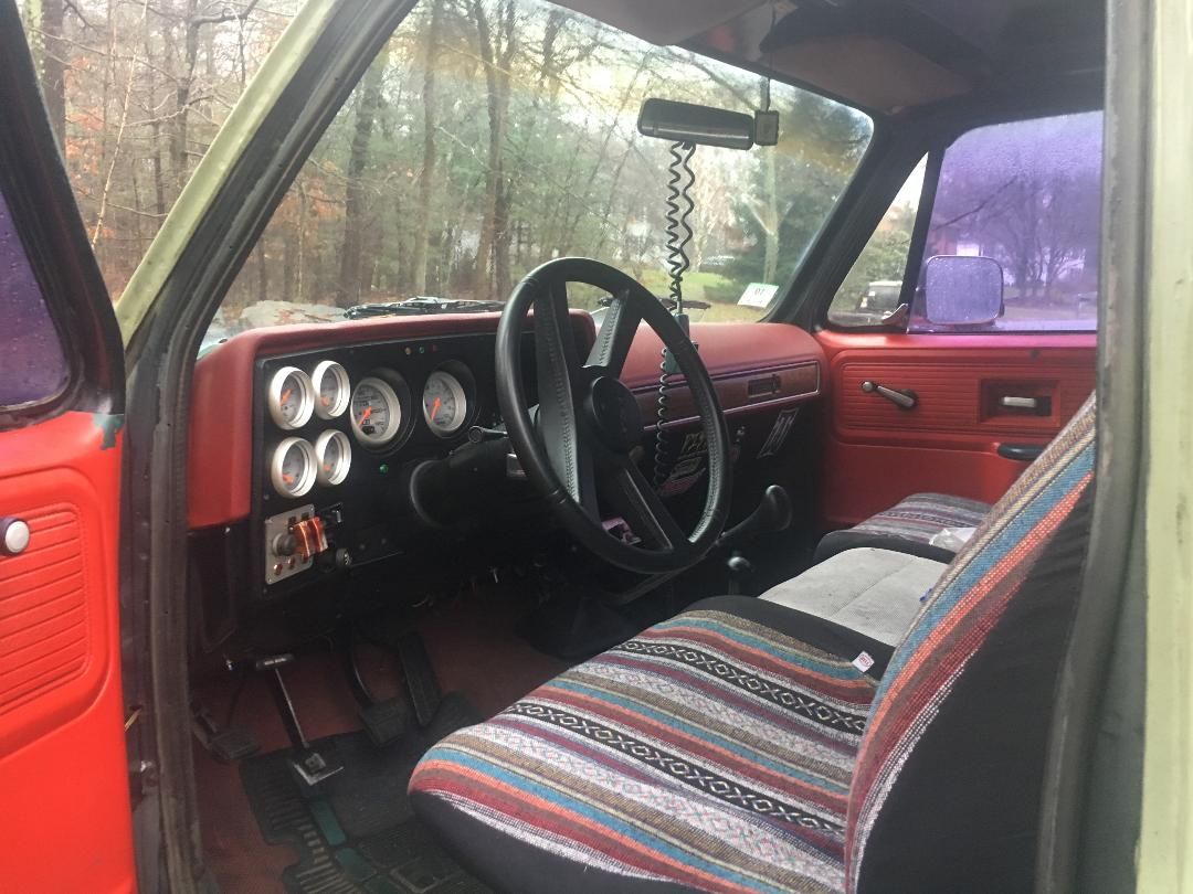

Also with eh diesel swap I installed autometer gauges and buckets seats

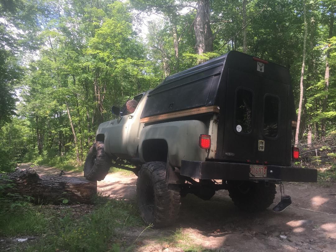

on 39.5x14.5r16.5 inch boggers
The camper cap. Came off a ford f150 with the 6.5 bed. Fits almost perfect. The wood since has been bed lined and sealed.
