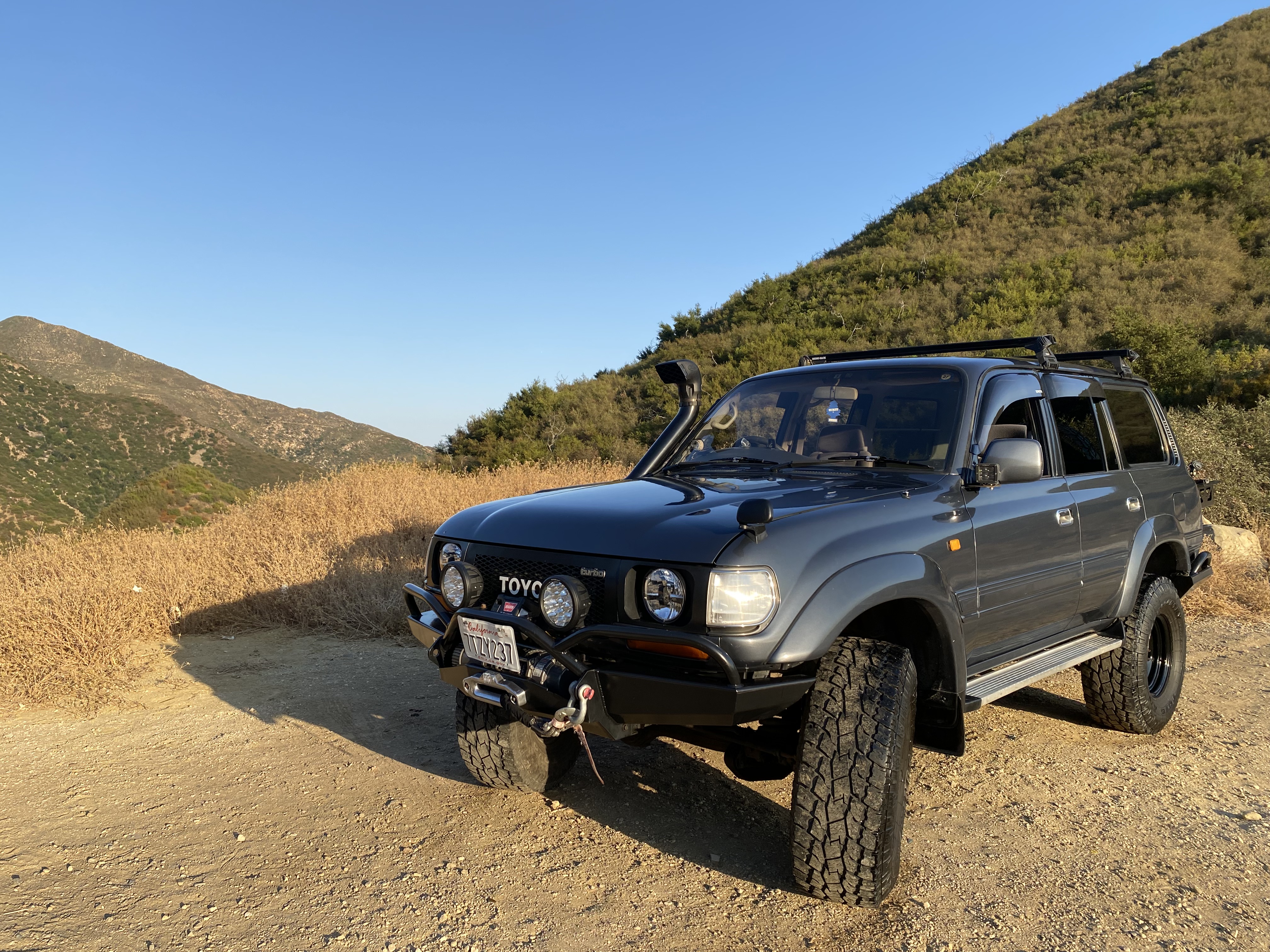

1991 Right Hand Drive, Turbo Diesel Toyota Land Cruiser HDJ81 which was imported from Japan and is registered/titled in California. I bought it stock 8 years ago from a Japanese vehicle import company and have been enjoying upgrading and driving it ever since. This truck has electronic locking front and rear differentials, a fridge in the center console with an ice maker, and other fun JDM quirks as well. I am selling it because I have three Toyota Land Cruisers and not enough time for them all.
The modifications make this truck a ton of fun to drive. In my previous gas powered Toyota Land Cruisers, there was always a feeling that the truck was under-powered. By comparison, this truck, even when fully lifted and loaded, has more than enough power at all times.

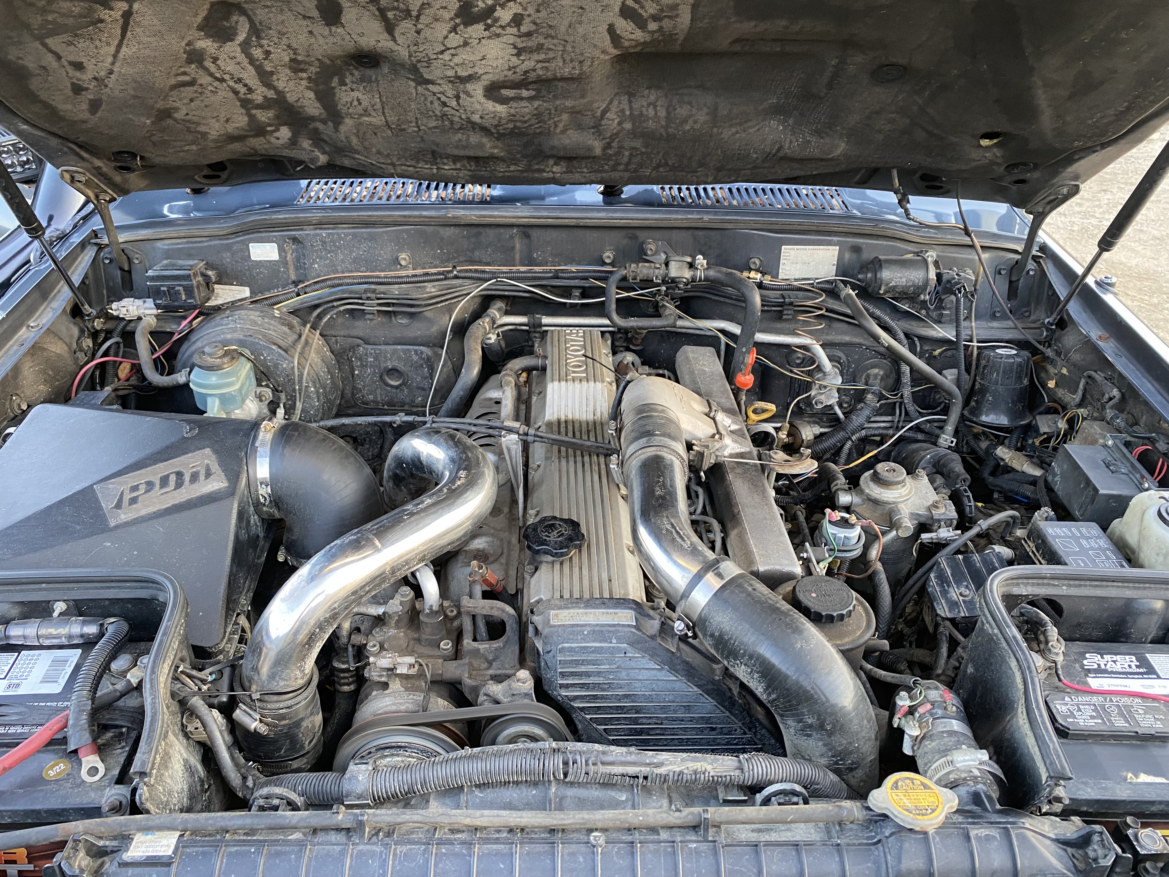

POWER MODS ($10,647)
- Upgraded Turbo with G Turbo grunter extreme $1415 (parts) (https://gturbo.com.au/)
- Manual boost controller
- Exhaust - Dea performance $703 (parts) (https://deaperformance.com.au/)
- Custom snorkel - moonlight fabrication $1140 (parts) (https://moonlight4wd.com.au/?srsltid=AfmBOorJREjIGdield-juOpCKO3cSBGUhgbbEycBS8GJn0MO-MmL8YGZ)
- Custom intercooler - PDI intercooler $974 (parts)(https://www.performancedieselintercoolers.com.au/products)
- Custom air box - PDI intercooler $636 (parts)
- Rebuilt/tuned injection pump and new injectors $5500 (parts and labor)
- Custom fuel pin $279 (parts)

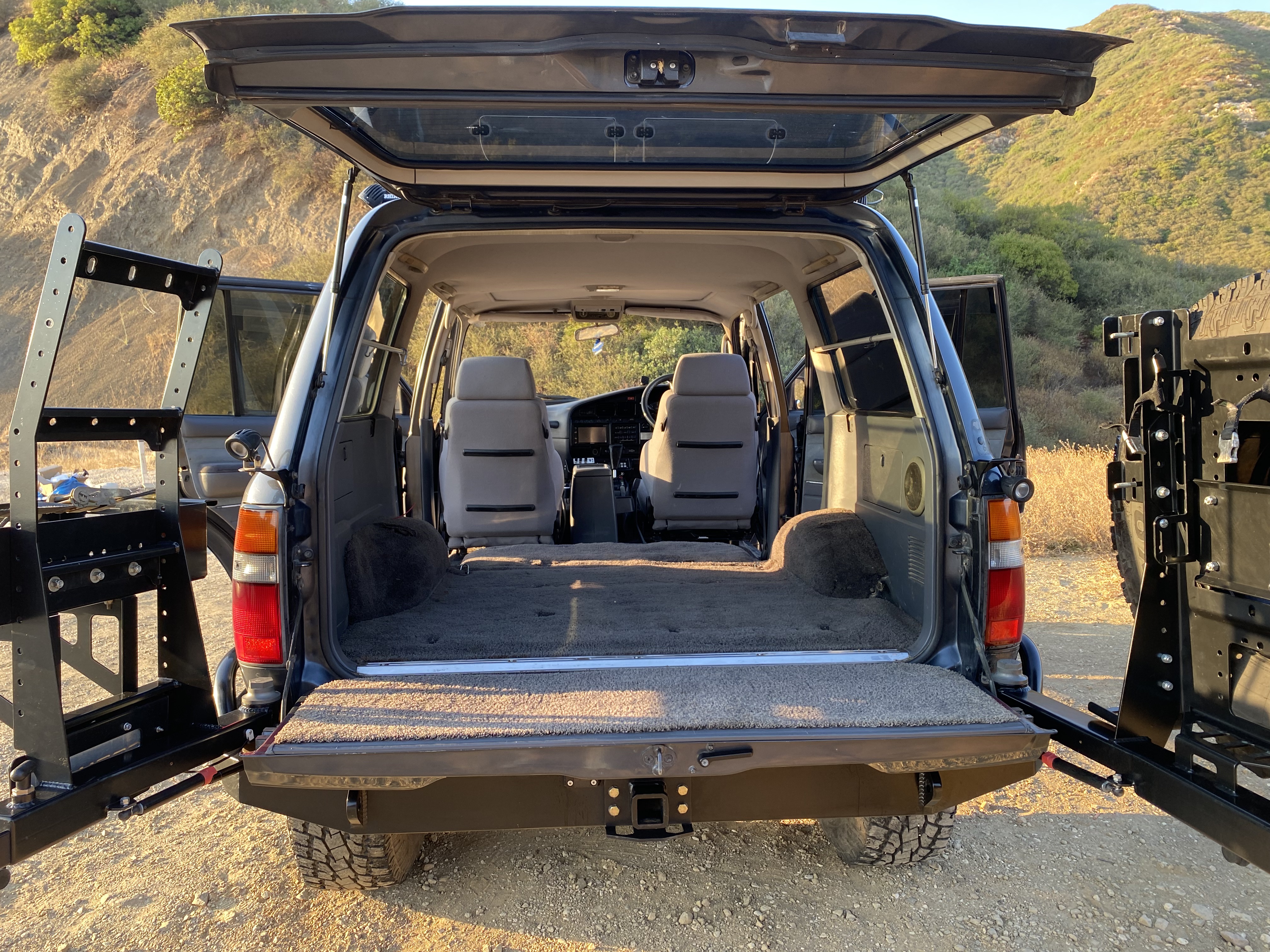

BUMPERS ($8236 without labor)
-SLEE front bumper $1655 (parts)
-SLEE rear bumper $4095 (parts)
-WARN wireless winch with synthetic line $1363 (parts)
-Swingout #1 holds 15 Gallons of water on one swing out $425 (parts)
-Swingout #2 holds 35” spare tires, maxx tracks , high lift jack $329 (parts)
-Added Slee Tow Hitch $319 (parts)

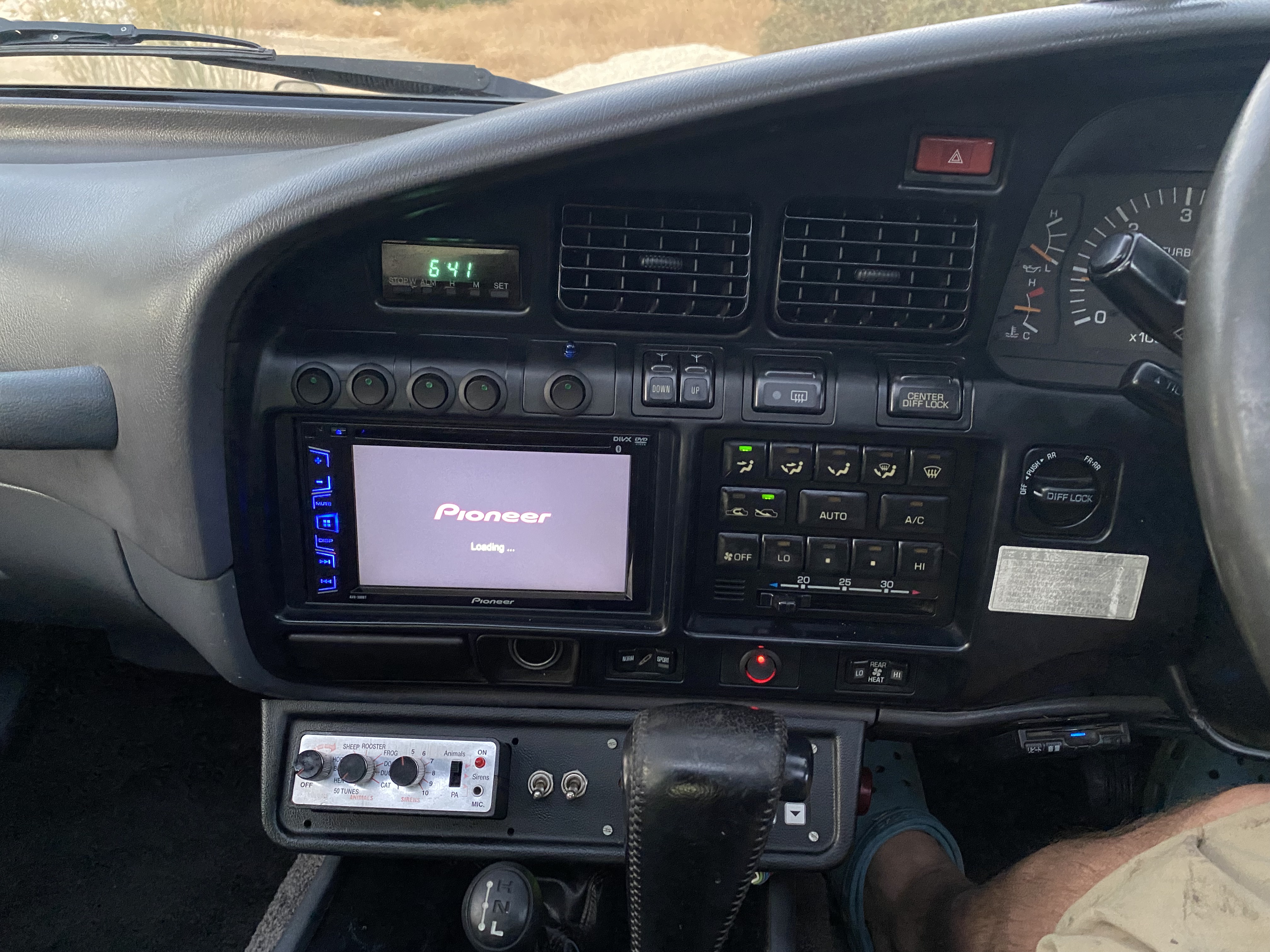

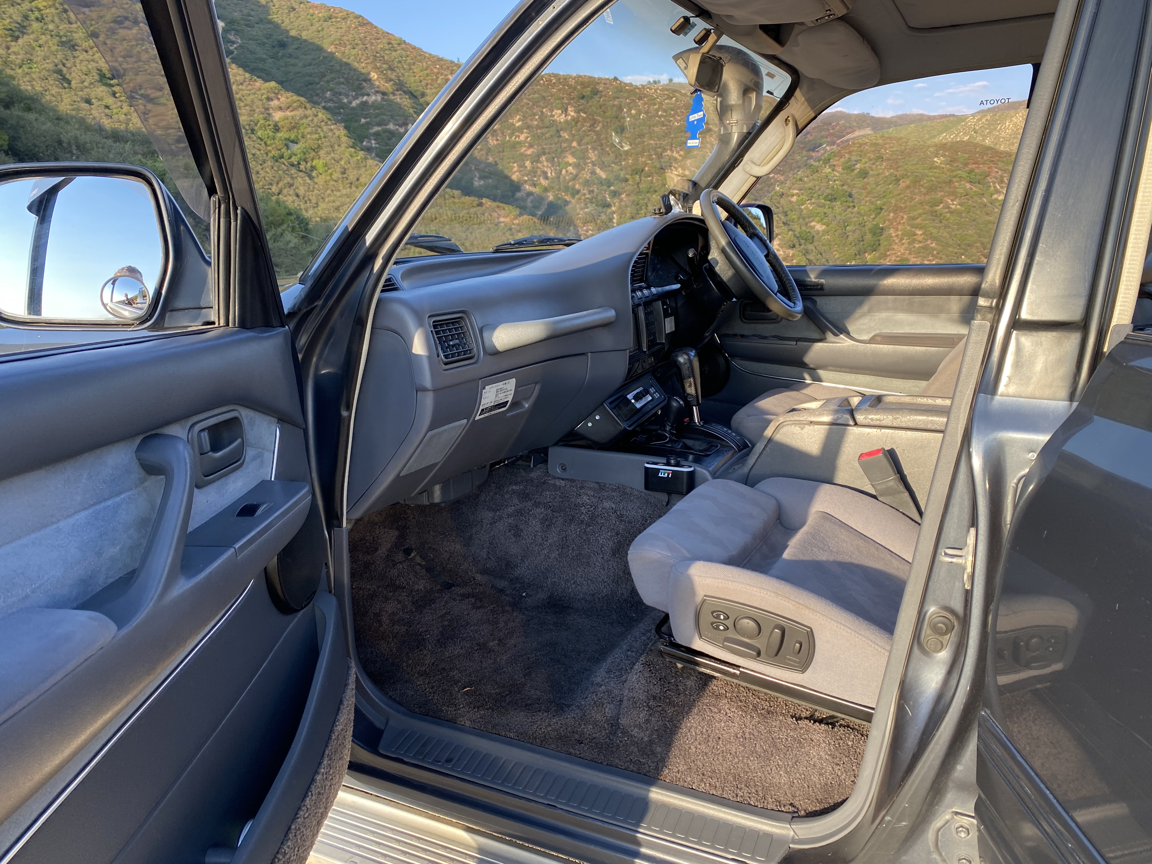

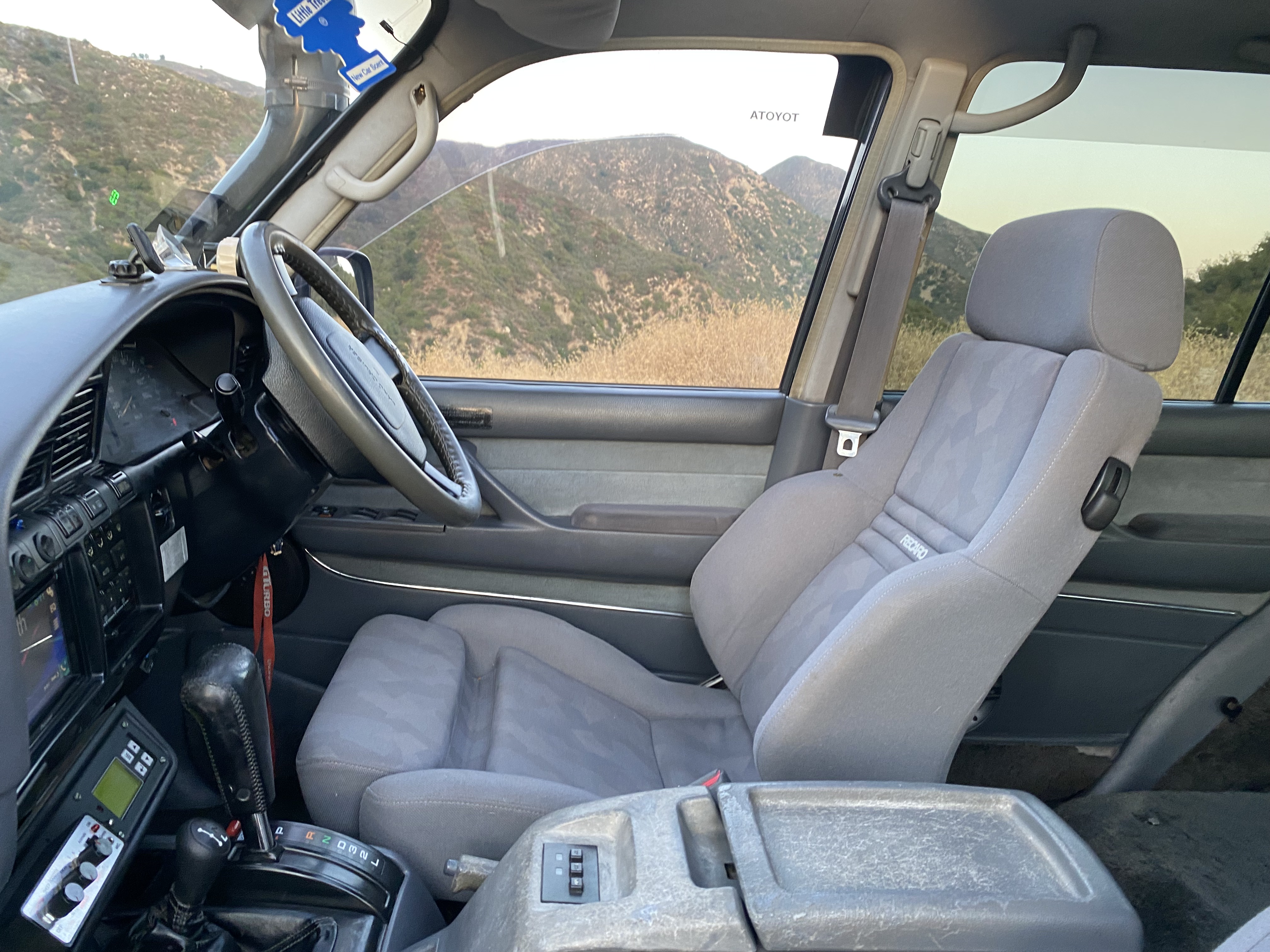

INTERIOR (over $11,000 in parts and labor)
-Dakota Digital gps speed sensor and dash display
-Replaced all glass window runs
-Recaro Orthoped seats with seat heaters and fans $6000 (https://cdn.recaro-automotive.com/f...ets/recaro-hotsheet-orthopad.pdf?v=1688076799)
-Upgraded LED interior lights
-Upgraded speakers and head unit $1500
-Replaced driver side window switch and multiple window motors.
-Added in keyless entry $1000
-Tinted windows $500
-Professional switch wiring for all aux lights $2000 total
-Added Slee Tow Hitch $319 (parts)View attachment 860388

View attachment 860387INTERIOR (over $11,000 in parts and labor)
