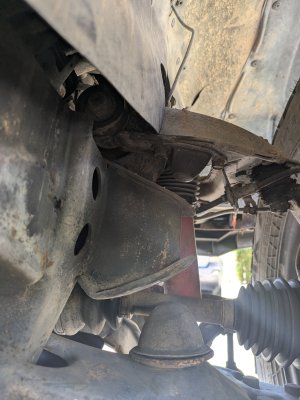

I can see that Monomax's are aftermarket; the drivers side one needs replacement. However, I'm somewhat concerned about the angle of the CV axle; is this something that should be remedied? I am considering getting the Aisin lockable hubs to allow free rotation to mitigate wear, as well.

Should be fine on the CV’s, again, not very much flex is even possible out of the front.
