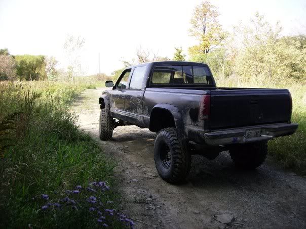

mr_crazy
ome617 ..... i watched one in and ifs pickup drag a cummins powered 94 gmc 3500 s.a.s qaud cab up a hill and had plenty of go i think the gmc is in the 8000lbs range its big
94 cummins powered quad cab
ome 617 pickup
proof its rammed in there

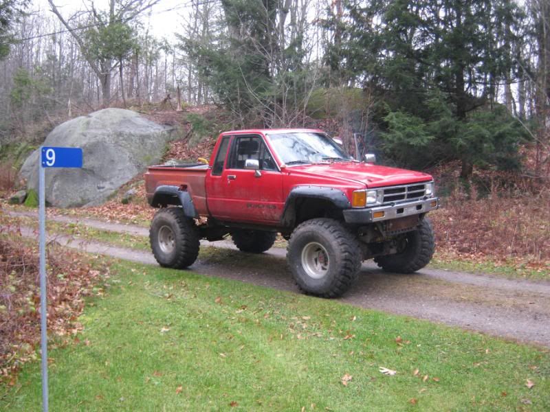

I have a Toyota on 1 tons and 42's that started out more expo friendly and slowly progressed into a street legal-ish rock crawler that get trailered anywhere more than an hour or 2 away. I am keeping it, but building a 1988 4runner on 33x10.50's with a low SAS, e-locker diffs, 4.88's and a 1998 Tacoma 3.4 engine. I also have a pickup bed trailer I made from a 1979 long-bed Toyota that was rolled. If you are planning to do a trip like the Road of Bones in Russia I would maybe consider all the spares you mention, but for most normal camping trips I think you will need much less. A winch, a friend and a tool kit with a few spare parts goes a real long way. I would recommend very thorough maintenance during your rebuild, check u-joints, belts, etc. and plan on carrying a little less and probably not even need the trailer or leave it at camp and explore with out it.
