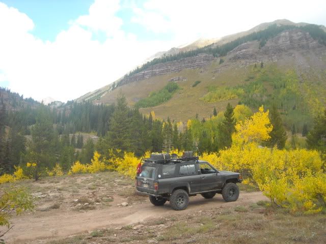

BTW, do you have a pic of your rig with the 255's? I would like to see how our trucks would look with that size.
Thanks
toyota_jon
This pic is before the OME lift.
