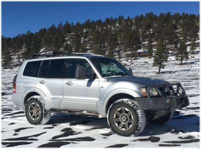

If you get the ARB bumper, you can go with medium duty or HD front springs. The bumper is right at the max for the medium duty springs to still result in 2" of lift so if you plan on adding any other constant weight like skid plates, bigger battery, winch, etc. then go with the HD front springs. I have HD springs all around, Bilstein 4600 shocks, and 33s (285/70R17) on 17" 4runner TRD wheels.
