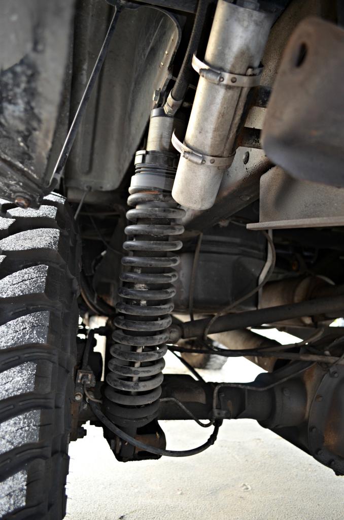

Below please find the inspiration behind the truck and early build profile. Since then we have had Rock Krawler's Suspension's owner and designer install the Solid Axle Swap with Hydraulic assist steering on the front end. Also have added a Class VI bumper tow hitch to the rear. The truck is truly bulletproof now.

Suspension
Rock Krawler 8.5" Solid Axle Swap Desert Race Suspension 6,500.00 http://www.raceindustry.com/part-sh...on-inc/3665-coil-over-desert-race-system.html
Radflo 2.5" Coil-Over Shocks with remote reservoirs 2,000.00 http://www.radflo.com/coil_over.htm
Radflo 2.5" Hydraulic Bump Stops 4" Travel Front aand Rear 1,500.00 http://www.radflo.com/hydraulic.htm#detailschart
Dodge Power Wagon Front Axle 1,300.00
Stainless Extended Brake Lines (x4) 350.00

front right.jpgdash board.jpgleft doors open.jpgTruck Profile.jpgREar corner.jpgFront axle.jpgFront suspension.jpgrear suspension.jpgSwitches etc...jpgTransmission.jpg
