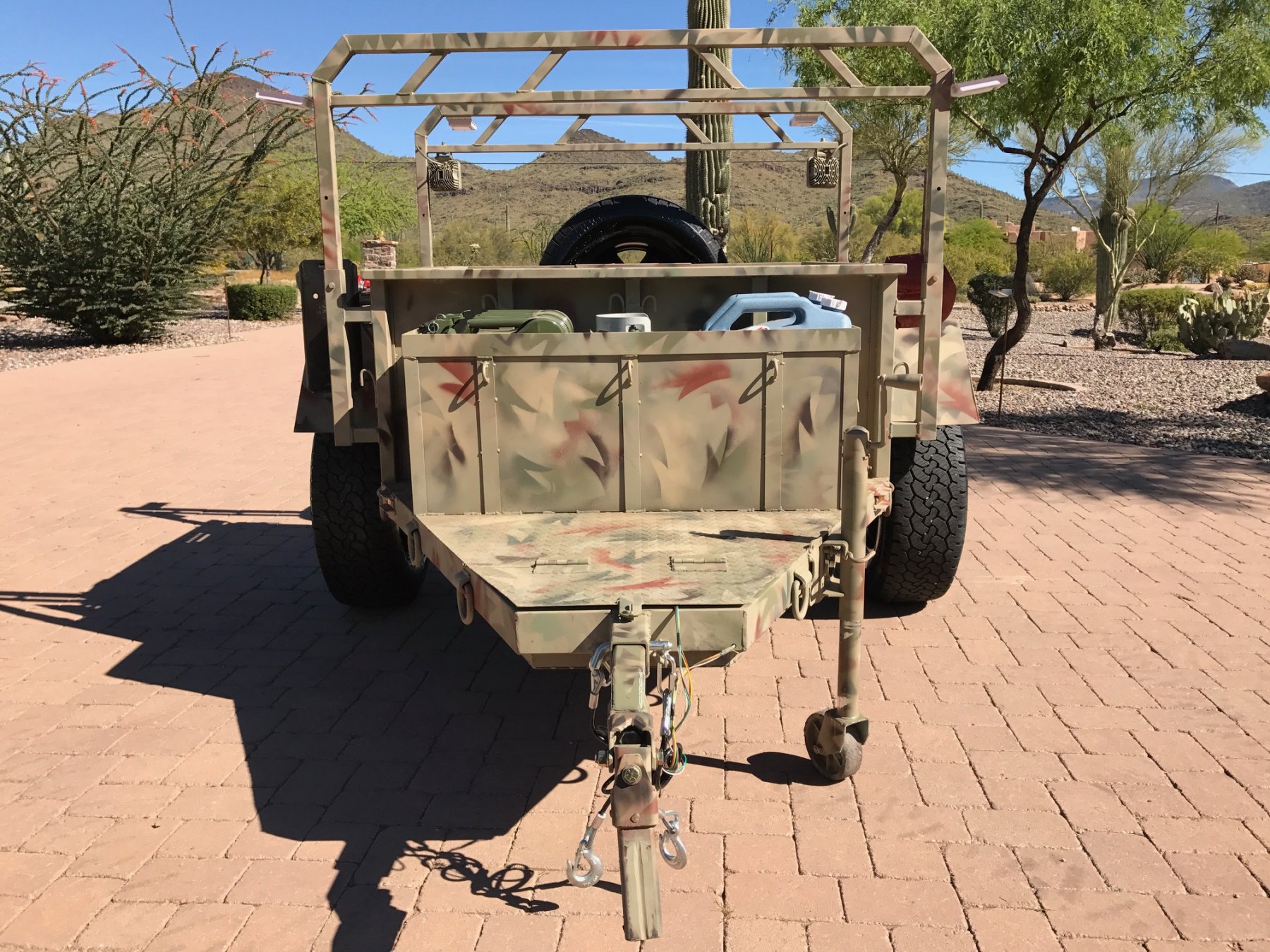

M8-A1 Mule STYLE Mil Spec Off Road Trailer for EXTREME HEAVY DUTY USE!
FINALLY AN OFF ROAD TRAILER BUILT RIGHT! LIGHT WEIGHT 675 lbs, TOUGH AND RUGGED WITH ALL THE RIGHT OPTIONS TO GET YOU INTO THE DEEP WOODS AND BACK CIVILIZATION!
WHEN PULLING THIS TRAILER YOU CAN BARELY FEEL IT, VERY SMOOTH AND TRUE, IT IS VERY WELL BALANCED! 60/40 AXLE split.

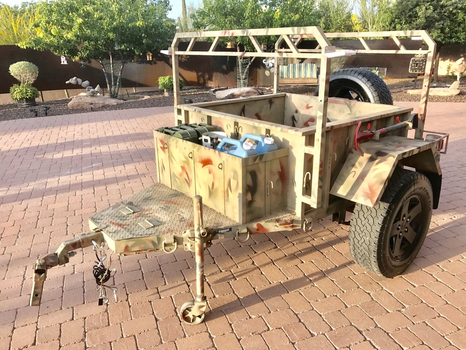

THIS M8-A1 MULE HAS THESE EXTRA OPTIONS ADDED... PROPANE holder, 10 gal WATER holder, 10 gal FUEL Holder and or front storage area, 23 HOOKS, ADJUSTABLE TENT RACK, 8,000 lb AXLE AND 6,000 lb LEAF SPRINGS, SOUTHWEST TRIBAL STYLE CAMO PAINT, ADJUSTABLE AND REMOVABLE TENT RACK, SPARE TIRE HOLDER.
THIS OFF ROAD TRAILER IS BUILT RIGHT! Thick tubing and an all welded design.
BOX SIZE 48" x 48" x 23" side walls
ADJUSTABLE TENT RACK ONLY 4 EACH 3/8" BOLTS FOR QUICK RAISE OR LOWER
HAS OEM 17" or 18" alloy JEEP Take Offs because most people want to match WHEELS to their own vehicle. 24" RV Jacks also available to lift tent.
OEM JEEP BEARING HUBS NEW 7,000 lb Rated LONG LASTING NON LUBE TYPE WORRY FREE only $35 each Off the shelf oem parts and easy to replace, 10 year warranty. Commander type jeep hubs. 5 on 5".
HEAVY DUTY 6,000 lb LEAF SPRINGS FOR NO TRAILER BOUNCE...tire bounce is different all trailers have that. When weal 1,000 lb leaf springs are on the trailer can start to bounce on a wash board dirt road. The 6,000 lb springs help eleviate this problem.
Standard is Super strong 3 Inch sched 40 wall Pipe Axle Tube NEW 8,000 lb rated
71.5" on center wheel track width
If it rains just cover the box with a tarp...simple. A metal box lid is pricy and it gets in the way sometimes, but I can build a lid for if you want not a problem.
20 HOOKS TO EASILY SECURE YOUR LOAD, TARP OR TENT.
8 each 'D' Rings to secure your heavy loads OR TO HELI LIFT YOUR TRAILER INTO REMOTE LOCATIONS
HEAVY DUTY HINGES ON TAIL GATE with SPARE TIRE HOLDER

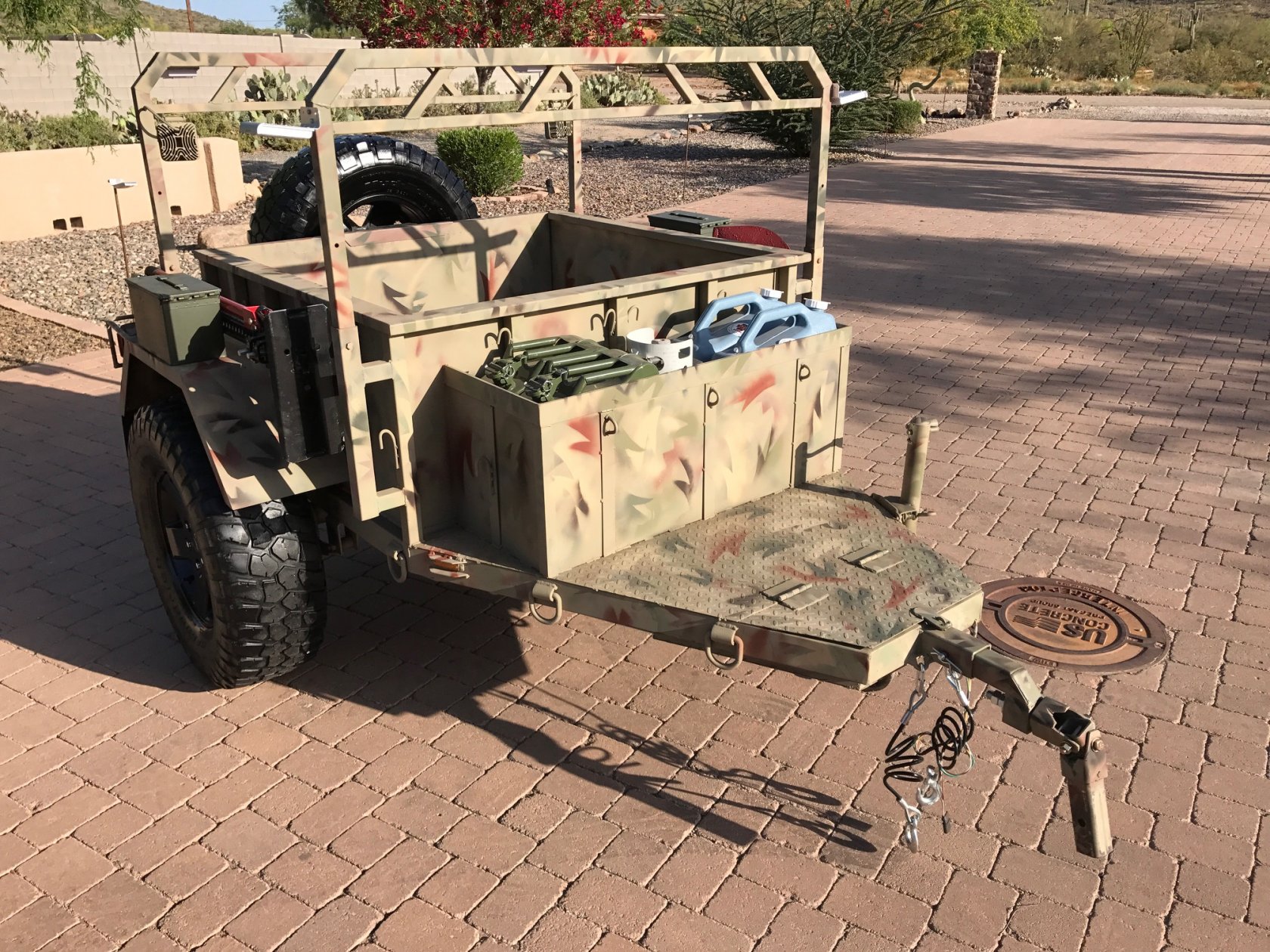

3 SIDES SHEET METAL FRONT TONGUE STORAGE BOX FOR PROPANE TANKS, FUEL CANS, WATER CANS OR EXTRA SPARE TIRE OR WHATEVER YOU WANT, LARGE STORAGE BOX ~15" x 45". THE SIDES ARE GUSSETS FOR THE FRAME TONGUE JOINT THIS MAKES THE FRAME INCREDIBLY STRONG WITH THE 17" x 14" 14 ga. Floor plate Gusset.
HEAVY DUTY FRAME GUSSET REINFORCED BUILT FOR EXTREME DUTY 16 ga. 1-1/2" x 3" Rectangular Tubing with 15 each 1-1/2" X 1-1/2" x .065 square vertical tubing struts surrounding the bed for maximum JOIST strength AROUND THE BED.
Skin and floor is all 18ga. Cold Roll sheet goods very strong and light weight ABOUT 5 times stronger than aluminum and only about 60% heavier than aluminum.
Other Off Road Trailers on the market ROCKBOXOFFROAD.com trailers start at $4,800 for a kit YOU GET a pallet of raw metal and then You have to weld it all together from scratch. IT TAKES ABOUT 20 HOURS TO JUST WELD A TRAILER TOGETHER. AND THEN LIGHTS 3 hours, primer and paint 8 hours, rill holes for adjustable tent rack...it is a lot of work. I have been a professional fabricator for 45 yrpears and it takes me 30 hours to basic version of the M8-A1 Ammo Mule.
RUGER Off Road trailers start at around $5,500
MOABAZ Off Road trailers are $6,500 and Up to $12,000
This type of Off Road Trailer has a lot of detail involved in the manufacturing process, about 30-60 hours of labor depending on options, this is why the cost is where it's at on this type of trailer.
