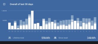

The screenshot below, captured from the Victron Energy solar charge controller, displays the energy collected by the system over the past 31 days. The white portion of each column represents the percentage of time spent in Bulk charge mode, while light blue indicates the Absorption phase and medium blue denotes the Float phase. The data shows that the system reached the Float phase on well over half of the days. This indicates that the system was fully or nearly fully charged for approximately two-thirds of the time. On October 20–22 and 30-31, rainy conditions limited solar input, while on October 23-24 the system quickly recovered pulling in as much as 1.08kWh on a single day.
This data is associated with the chart above. I attempted to attach the CSV file to this post for further review but the uploaded file does not have an allowed extension.
