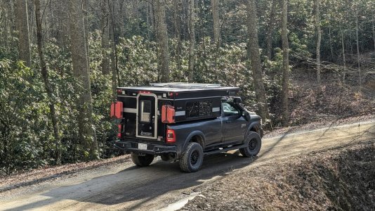

IDK man, although being a one off, would be willing to bet that anything similar produced in any kind of production /“professional” fashion probably wouldn’t look much different than what you did.
Your encouragement means a lot - thank you. While I appreciate the vote of confidence, I know there are skilled professionals out there who would spot plenty of rough edges in what I've built. I approached this as a personal challenge with what I had on hand: basic tools, limited experience, and everything done right in my driveway using just a single extension cord. It wasn't perfect by any stretch, but it was a rewarding hands-on project, and I'm genuinely glad others followed along and shared in the journey. If it inspires anyone to try something similar (or do it better!), that's more than enough for me.
Have you measured temperature inside the box when heat was in use? It would be interesting to see how hot it gets and the longevity of the equipment inside. I assume one fan is in a push setup and the other is in a pull setup?
Yes, I monitor the internal temperature of the Zarges K470 enclosure (what I'm calling the MES-K470 setup) using a probe tied into an Inkbird ITC-1000 controller. That feeds a compact Noctua NA-FC1 fan controller, which handles two Noctua NF-A12x25 PWM fans in a push-pull arrangement - one pushing cool air in, the other pulling warm air out.

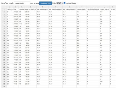

I set the fans to kick on at 90°F and shut off once it drops to 80°F. To size the system, I ran through various load scenarios (mixing solar charge controller output, DC-DC charging, inverter draw, diesel heater operation, etc.) in both hot and cold ambient conditions, then designed around a conservative worst-case estimate. With the fans at full PWM speed, they move enough air to refresh the enclosure's internal volume dozens of times per minute - plenty of margin for the loads I run.
As one example taken moments ago: with the diesel heater on low, the solar charge controller active, and the inverter running, the internal temp stabilized around 85.2°F (battery at 97.6% SoC, solar input just trickling at ~3W in float mode). I'm pleased with how it performs under real use, though I fully recognize the setup is more elaborate than most people would need - this was largely an engineering experiment and learning exercise for me.
If you're building something similar, I'd be happy to share more details on the calculations or component choices; happy to help anyone avoid some of the trial-and-error I went through. Thanks again for engaging!

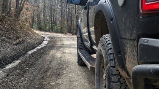

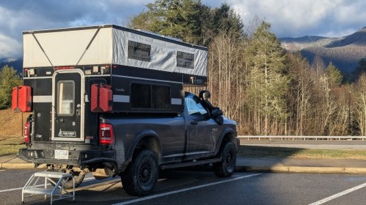

I selected the Luverne Grip Step 7" x 98" aluminum wheel-to-wheel running boards after a thorough search for options suited to a regular cab with long bed. Full-length boards proved scarce - most covered only the cab area - while I required frame-mounted brackets exclusively, avoiding any rocker panel attachment. I also prioritized a flat platform with expanded metal tread surface for superior traction and debris shedding in demanding environments. These Luverne steps uniquely met all criteria, making them the clear choice for my build.
The 7-inch-wide stepping surface ensures safe, comfortable access and egress. The open expanded metal treads effectively shed dirt, snow, and debris from boots, and the powder-coated aluminum construction delivers strength, low weight, and complete rust resistance.
As installation neared completion, I briefly considered omitting the end caps. Upon reflection, their smooth, rounded profile eliminates sharp edges and neatly conceals what would otherwise be an exposed, unfinished end - enhancing both safety and aesthetics.
Two standout features deserve mention. First, the expanded metal tread pattern matches that of my camper entry step stand, creating uniform footing and boosting overall safety. Second, the running boards mount at precisely the same height as the top step of my stand. This eliminates the need to haul the stand when securing or releasing the front four roof latches on my Four Wheel Camper - a small but meaningful efficiency gain. In freezing conditions (teens or twenties), manipulating cold metal saps hand warmth quickly, and gloves compromise the dexterity needed for those stubborn latches - making this integration a genuine time- and comfort-saver.
This is the front mounting bracket on the driver's side. The powder-coated brackets employ stainless steel fasteners and exhibit high-quality fabrication.
The instructions were thorough and illustrated, but contained a notable gap: body mount bolts are to be discarded without reuse, yet no guidance addresses the substantial factory washers (~4" OD). Luverne tech support offered no explanation for their function and insisted on non-reuse per the manual. Observing the kit's bolts were 10 mm longer each, I applied basic load-distribution logic: the washers must remain to spread force evenly over the rubber body bushings. This critical detail appears to have been omitted during the transition from design to documentation.
Here is the rear cab bracket on the driver's side. On a crew cab, an additional body mount and bracket would appear between front and rear; for my standard cab, only two per side are required. Vertical adjustment capability here is a smart, practical touch.
Close inspection of the load reaction studs reveals how they preload the brackets against the frame, channeling step loads directly into the chassis rails. This is a solidly engineered approach with broad adjustment capability that impressed me.
The rearmost bracket attaches to the side of the front eye bracket for the rear leaf spring on my one-ton truck. It uses a 30 mm head bolt torqued to 350 ft-lbs (my son handled the final torque). Horizontal adjustment is available if needed. In summary, the frame brackets reflect thoughtful, heavy-duty engineering with practical adjustability.
