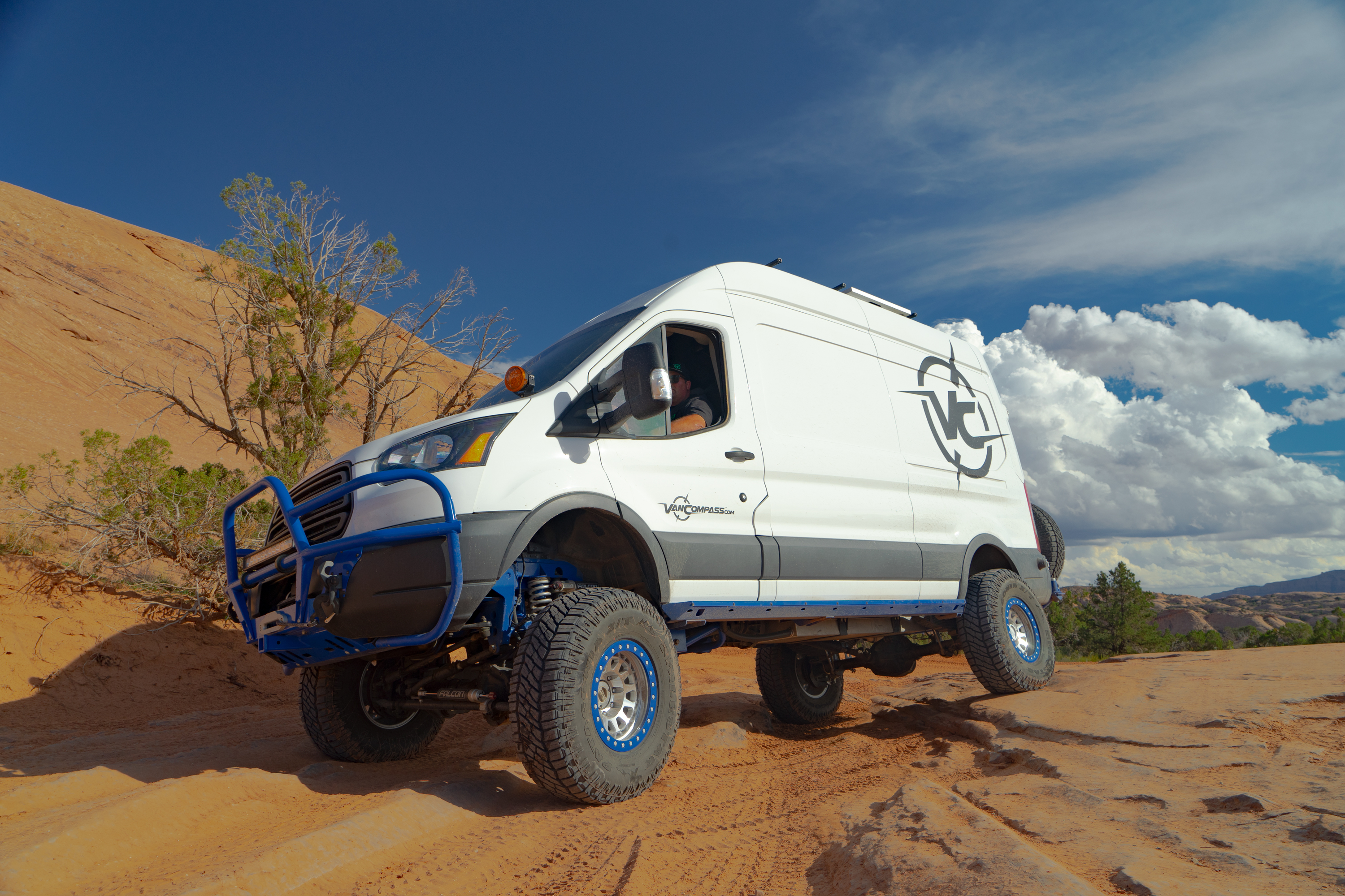

One of a kind Ford Transit 4x4 conversion performed by Van Compass in 2019. This rig gets all the looks and is a blast to drive.
Drivetrain
  • 43K Miles on motor/chassis
- 3.5L Eco boost gasoline motor
- Custom 38 Gal aluminum gas tank
- 4x4 swap completed at 32K miles
- 6 Speed Automatic transmission - rebuilt at 38K miles. Upgraded at Power By The Hour with upgraded friction clutches and steels, V8 internal piston, modified center support to produce more fluid flow. New Factory Ford torque converter installed.
- NP273 divorced transfer case, electric shift, rebuilt before installation with new chain, bearings, seals.
- 2004 Super Duty Front axle, 4.88 gears, eaton electric locker, manual locking hubs
- 2004 Super Duty Rear axle, 4.88 gears, rebuilt limited slip.
- Black Rhino Primm beadlocks x 5 with 37’ Milestar Patagonia X/T tires
Suspension Front
  • BDS Super Duty Radius arms attached to custom chassis radius arm brackets
  • Eibach coils mounted to custom chassis coil buckets
  • Falcon 3.3 Fast Adjust Shocks mounted to custom chassis mounts - custom valving to van weight/suspension design
  • Bump stops set to correct height for full suspension compression
  • BDS HD Super Duty Track Bar attached to custom frame track bar mount
  • Stock Super Duty crossover steering
  • Jeep WJ Steering box attached to custom chassis mount
  • PSC motorsports highflow power steering pump and extra large reservoir (hydraulic assist ready for a drilled and tapped PS box)
  • Falcon Adjustable steering damper
Suspension Rear
  • Custom leaf spring pack to achieve lift and proper spring rate. Bolted to factory mounts.
  • Falcon 3.3 Fast Adjust shocks - custom valving to van weight/suspension design
  • Rear bump stops set to correct height for full suspension compression
Performance
  • 5 star engine tuning tool with an Eco 87 octane tune, 87 towing tune and 91 towing tune
  • Catalytic Converts removed at turbos in place of custom downpipes and crossover. Check Engine light shows from this mod and exhaust smells. Improved power and mileage.
  • Factory muffler removed and straight piped.
  • High flow catalytic converter installed (still smells like it is missing the catalytic converters)
  • Scan Guage II for live temp monitoring
Exterior
  • Custom Winch bumper with removable grill hoop. Smittybuilt 12K winch. Front 2” receiver for bike rack.
  • Vision X Light bar
  • Vision X pods on A-Pillars
  • VC rocker guards
  • VC custom rear dual swing out bumper. 37” spare on Driver, Large box and Custom tubes that can be used for 1-Up bike trays or ski mounts
  • Ford roof rack with VC awning drop brackets. Thule Awning and 180 watt solar panel attached.
Driver Convenience
  • Always on rear view camera
  • Driver phone mount
  • Factory ford towing mirrors with defrost
  • Cruise control works!
  • Speedo reads 3 MPH slow at 65 MPH
  • Christmas light gauge cluster - ABS, traction control, Tire Pressure, Check Engine light show on dash. The rear tone rings need to be replaced. We have spares. This will fix the ABS and traction control light. They used to be turned off. I did not install the tire pressure sensors and the CEL is from the missing Catalytic converts.
Van Life Stuff
I’m by no means a professional interior builder. This was built to be spartan, durable and lightweight. The factory plastic panels have be removed for installation on all walls/ceiling, then re-used to save weight and
  • Seating for 4-5
  • Rear seats are tabbed and bolted to L-track studs. Easily removable. The 2 person bench can be removed and the single seat can be moved into its position.
  • Front passenger swivel seat
  • Insulated window covers
  • 5K diesel heater (CHINA) under passenger seat
  • VC overhead shelf above driver/passenger front seats
  • Campovans hanging gear bag along the driver upper wall. Clips in place. Easy to remove and haul clothing into the house to pack/unpack.
  • VC flip and load bed queen system. Up for kitchen galley use, hauling stuff etc. Down for sleeping. 8'' thick memory mattress and Froli sleep system. The bed will fold up further if you go thinner BUT I like to sleep in comfort. You will too.
  • VC 58” kitchen galley. Propane stove that runs off 1lb bottles. Cold water sink that drains to nature. TF130 fridge - All bolted to the floor and walls of the van. Not going anywhere.
  • VC rear fender box. 20 Gal fender water tank. Hose bib at the back door of van for exterior camp lux hot shower or just a nice hose to spray things off.
  • MaxxFan with remote
  • VC storage trunk set up with (2) Renogy 100 amp Lithium batteries, Renogy 20 amp B to B charge controller (alternator charging), Midnite Solar “The Kid” solar charge controller, ARB Twin air compressor and hose.
Quirks
This van is by no means perfect. It was built in our spare time over the past few years. The divorced transfer case produces drivetrain noise similar to an old truck. There are some acceleration and deceleration vibrations and clunks due to the multiple driveshafts. My wife and kids will drive on road trips with me, but it is not a luxury van. The steering feel can be described as a lifted Super Duty with 37s. The 4x4 is engaged with a momentary toggle switch. There is no light, you just need to know what you are doing. This rig is for an extreme overlander that wants a van, a youtuber that wants to get all the views or just a fella who likes something that is one of a kind. AS-IS - NO WARRANTY
