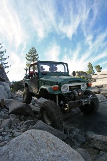

picture of my cruiser below, there has been updates since this picture. :smiley_drive:
