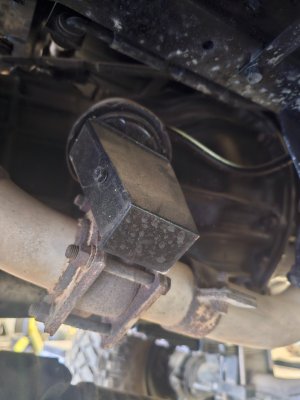

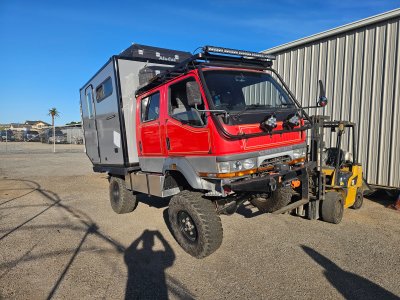

Im building a client's 95 canter 4x4 double cab overlander with the 4d35 engine. My question is were doing a turbo setup with 3" exhaust. Does anyone know of a factory vacuum exhaust brake with at least a 70mm port. Any help would be greatly appreciated. Ive seen other people speak of f417 exhaust brake but it seems to have a different style setup. Any help with this would be amazing

There are quite a few viable options out there.
Personally, I got one off an Isuzu FVR, and with only very minor modifications, it was ideal for the task.
I think the brake on the FM can also be modified by simply swapping out the actuator with the vacuum one on the Canter.
Both of these models are available in Australia, but I am not sure if they are in your neck of the woods...
