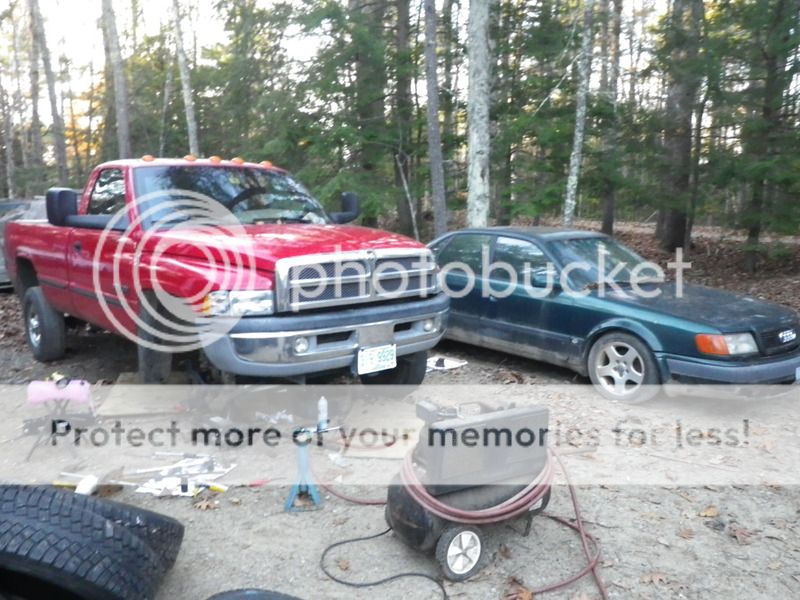

bloodyWEST - I used this http://www.pirate4x4.com/forum/dodge/874442-dodge-ram-2500-4x4-dana-60-hub-removal-converison-ford-knuckles.html for reference. On my first browse through I was all sorts of surprised and in awe at a girl wrenching on her 24v, until I looked closely and noticed I went to high school and wheeled with her, small world. I did run into an issue where dodge uses a nut on the outer end of the axle shaft and ford used clips in the diff on the '93 F350 axle I sourced, so I was using the wrong end of both shafts and everything floated back and fourth to the point where it might bind up. I cut a grove and put in a circle clip.
Simply, you keep the dodge axle and center section, and use Ford F350 (92-95? i think, but don't trust that) knuckles, outer axle shaft, spindle, rotors, brakes, hubs, bearings, ect.... So from the ball joints/outer shaft to the hub is ford parts, bigger dual piston brakes, serviceable bearings, and free spinning hubs.
There are other 1/2 ******** ways of doing it, drilling the stock 4 bolt Dodge knuckle to mate up to the Ford's 5 bolt spindle, but I wanted to cannibalize it as properly as I could, I'm looking reliability traveling with the camper and all. I'd be glad to answer any other questions, I found a lot of info missing and had to figure it out along the way.

Great rig Freeskier125! That is the perfect Dodge….standard cab, manual trans, 5.9L Cummins, and now with locking hubs. Sweet!
