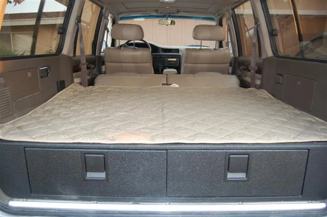

I also want to do some rear drawers system similar to this
attachment.php
If anyone has other suggestions to do feel free to let me know.
