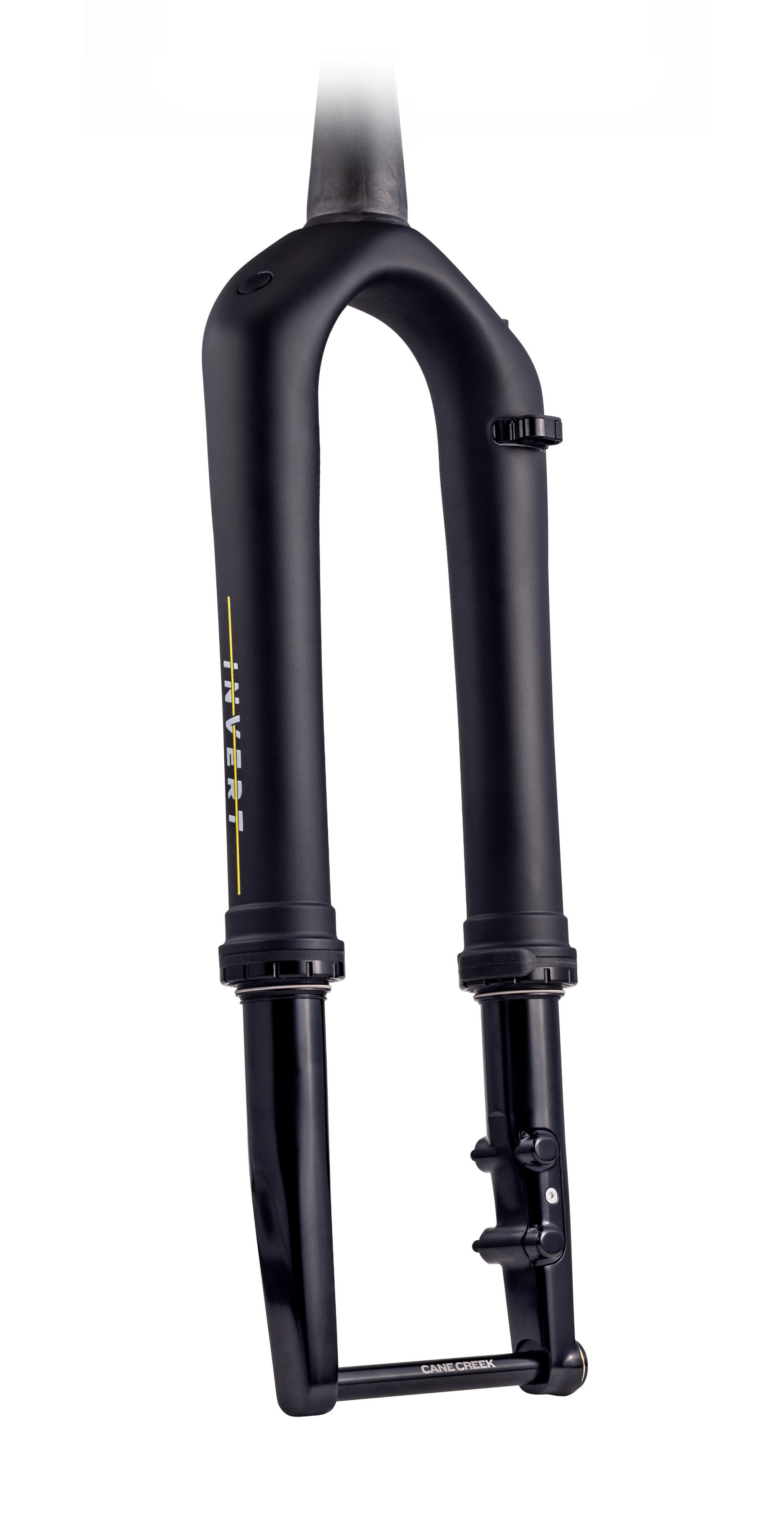

Here’s an alternative to the Ruby front fork included with on the Salsa Stormchaser. I have no experience with any of these.

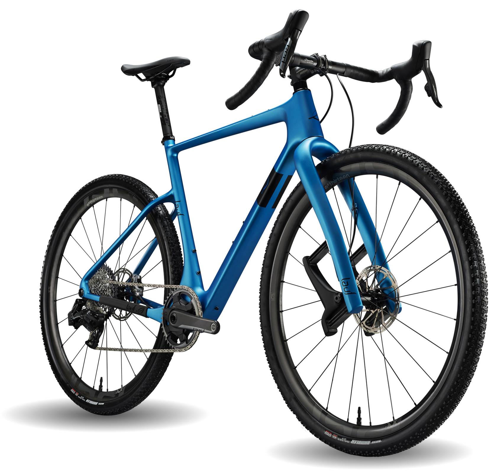

I'm with Howard70 on this. Tire volume is the key to a compliant ride without added cost, complication, and weight of a suspension fork. I also have a Cutthroat and ride it mostly with 2.2 Race Kings set at the low 20's psi, regardless of road or gravel surfaces. It is geometry corrected for a suspension fork if you decided you want to add that later. My road bike stays on the trainer in the basement and hasn't seen daylight in 2 years! Any gravel bike with big tire clearance will do the same, and each year the standard for acceptable tire clearance on gravel bikes goes up. The research on rolling resistance has changed out views that wider tires have to be slow. The Lauf Seigla is on my short list, and is a great bargain with or without their front fork. I can ride my Cutthroat almost anywhere without feeling like I am on the 'wrong bike'. It is definitely the bike you want for the zombie apocalypse, FYI. Cutthroats haven't really changed much so you can look at 2021-24 bikes used to save money.
