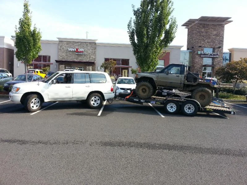

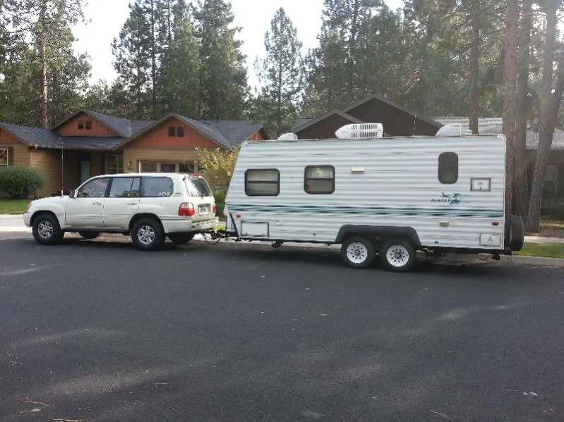

I tow quite a bit with my 2000 LX470. I wish I would have waited for an '03, just to have the extra gear in the transmission. That being said, she actually tows very well. I have added rear air bags and a trailer brake controller because I tow a lot of different trailers. If you are just towing the Airstream, I would recommend a good load-leveling, anti-sway hitch and electric trailer brakes. You should be happy with how it tows.
forumrunner_20121002_224115-jpg.681298
forumrunner_20131029_141502-jpg.823851
