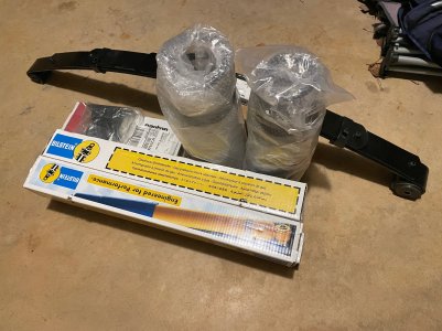

The suspension is sagging a bit, so I've ordered springs that, I think, will get me pretty close to the ride height of a stock XJ with the Up Country Package. I ordered a set of Bilstein shocks to go along with them. I'm looking forward to seeing how it all works out. For tires, 225/75r16 seems like a decent compromise so I'll grab a set of 3PMSF all-terrains. Given all of the space in the Jeep vs my Sentra, a larger ground tent is on my mind. Crawling in and out of my small 2P tent is kind of a drag. Something like the Gazelle T3 seems like it'd be a huge upgrade; maybe a RTT? I'll keep an eye on the used market and see what I can find.

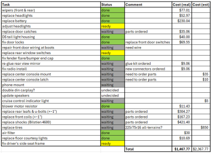

To-do list:

I had grand visions of getting started on a suspension refresh today, but I’m a dummy and only ordered one leaf spring. Whoops!
The springs are stock replacements for the Up Country Package. If they work out like I hope, I’ll add some PNs. Fresh sway bar bushings and jounce bumpers are going on as well. Everything else looks OK, so I’ll leave it alone for now.

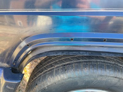

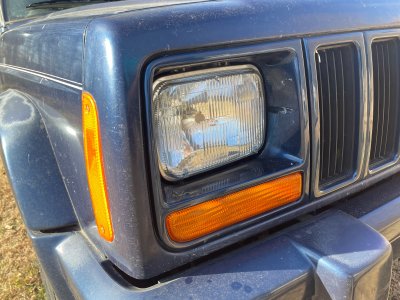

The headlights only worked on high beam and they were really dim. I was fully expecting to be swapping out some switches, but I was pleased to find it was just the headlights themselves. I don’t think I’ve ever seen a sealed beam in such bad shape. The glass had separated and the reflective coating had pretty much all worn off of the back. Nuts. Also, I pulled the front driver’s fender flare to refit it properly from where one of the previous owners had bumped something and just zip tied it back into place. Stoked to find the fasteners on the mounting strip weren’t stuck and the fender is rust free. 🤘IMG_9614.jpegIMG_9618.jpegIMG_9616.jpeg

If you choose to go with LED headlights in the future, may I suggest these? Plug and play, bright and they can easily be aimed to avoid blinding everyone else.
I would also suggest you avoid changing the markers and blinkers to LED. The antiquated management system doesn't like them, even if you change out the blinker relay with one that's LED friendly.

I haven't had super great luck with replacement LED bulbs, they don't seem to last any longer (IMO shorter) than normal ones and cost much more to replace.
I had them in the side marker lights and license plate lights on my Ranger, as they died within a few years they were replaced with normal bulbs that cost less than a buck.
@Somecallmetimm I’m not a fan of LED’s. I may wire in some relays to give these sealed beams a bit more voltage, but they’re reasonably bright as-is. I could see some driving lights being useful if I end up doing many overland trips. I’ve learned from motorbike trips that I lack the discipline required to stop and set up camp before dark. 🤣

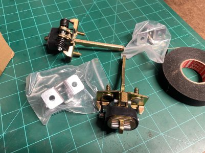

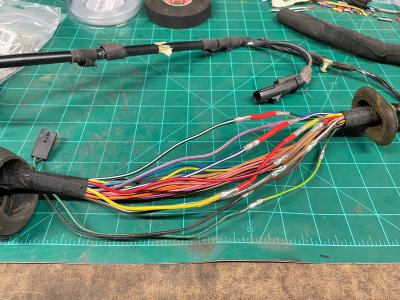

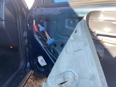

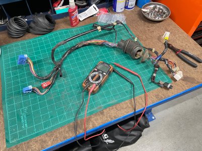

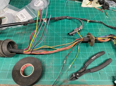

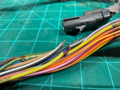

Today’s task was to troubleshoot my passenger power window. I suspected a wiring issue and sure enough. I was tempted to order some connectors and completely rebuild the harnesses, but I reckon this will do for now. Gonna put it all back together tomorrow and see how it goes.
Interestingly, the cheap Harbor Freight wire that I used has a way higher strand count than the OEM Jeep stuff. No wonder these harnesses always break.

Would think the drivers side would fail first.
The one with broken wires was on the driver’s side. Passenger side was in pretty ok shape aside from one cracked wire.
