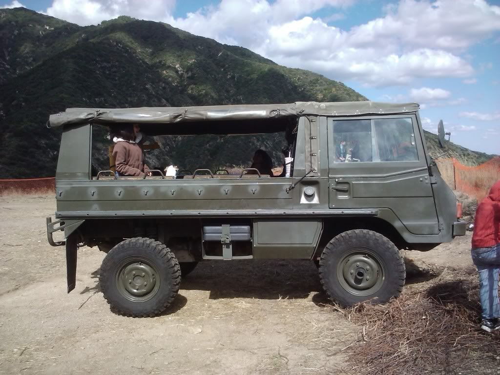

Is it realistic to expect that a 5 gallon gas can thats mounted flat (i.e. laying on its side) won't leak...or am I dreaming?
Louisd75
Those AT gas can holders are nice and their entire website is filled with lots of high quality goodies at gold prices, but dang, at $128 each I'd like to find something cheaper.
Depends on the can. I'd have no problem storing a NATO steel can on its side. On Pinzgauers they're stored on their side:
