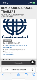

Apogee went into receivership in July 2023, locked the factory doors, walked away and neglected to tell anybody about it, including their dealers or customers. The phones are still working, but the voice mailboxes are full and you get an apology message in melodious French. Their Facebook page went silent - as a Canadian dealer told me, "It was like they suddenly dropped off the face of the earth.".

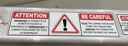

It is CRAZY dangerous, especially the bigger trailers, with multiple pinch points with risk of finger amputation or severe head trauma. One dealer noted that people with limited strength or mobility should not operate it.

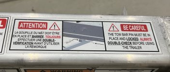

The tailgate has a pair of nice usable, lightly loaded compression latches at the top. It doesn't move around when stored vertically. The center hinges have zerks (dry), the bottom hinges do not have them. The tilting bed connection up front uses an inadequate similar clamp that is WAY too small for the job of holding down the up down motion of a bouncing, loaded trailer body. No easy fix, maybe install a set of HappyJac spring loaded camper tie down turnbuckles.
