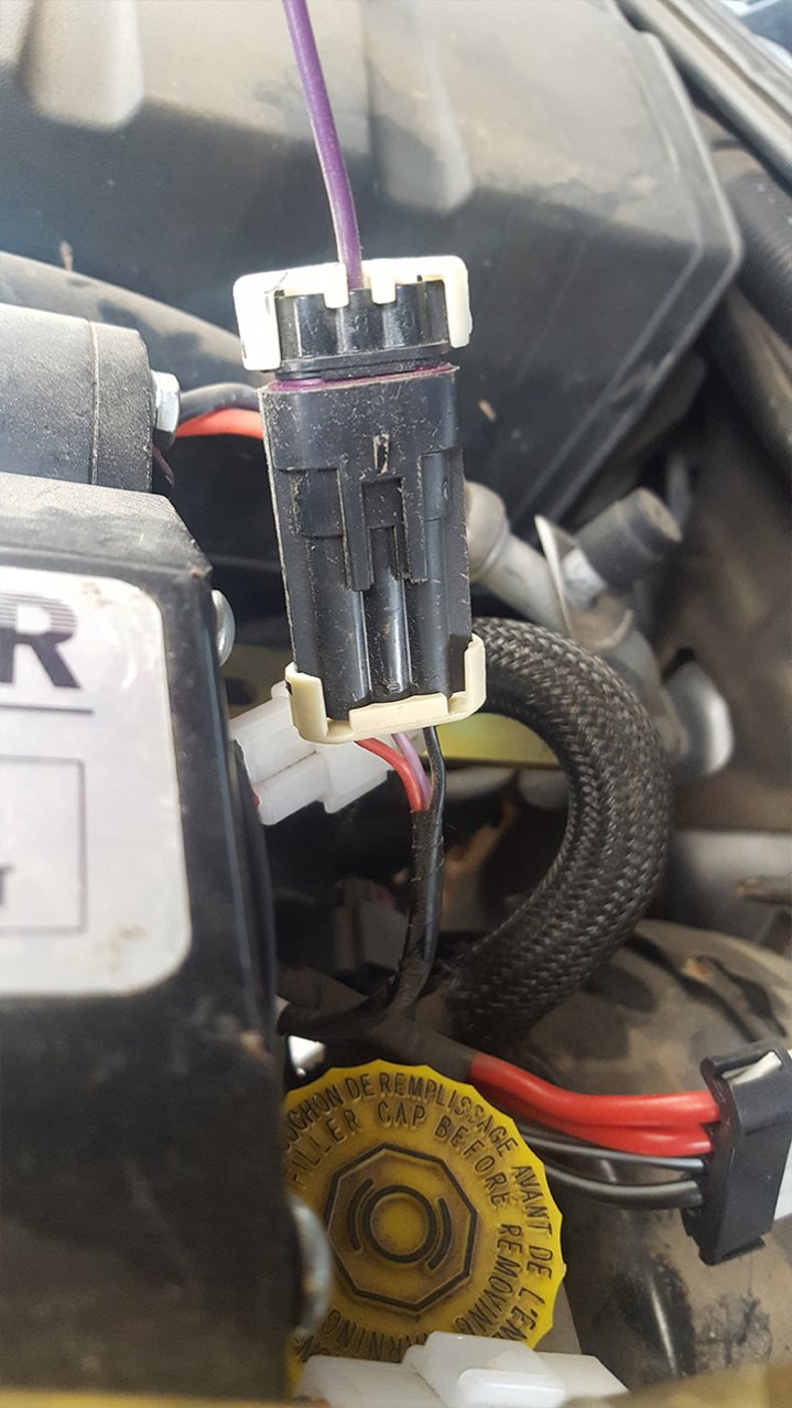

The wire that plugs into the compressor has 3 wires that continue into the wiring harness, but only one is actually needed if using an sPod, the switch wire. I have assembled such a wire and dubbed it the J-WIRE. I have put together an exact replica of the factory wire with the same Delphi connectors using a Delphi crimp tool. These are water proof and factory grade.

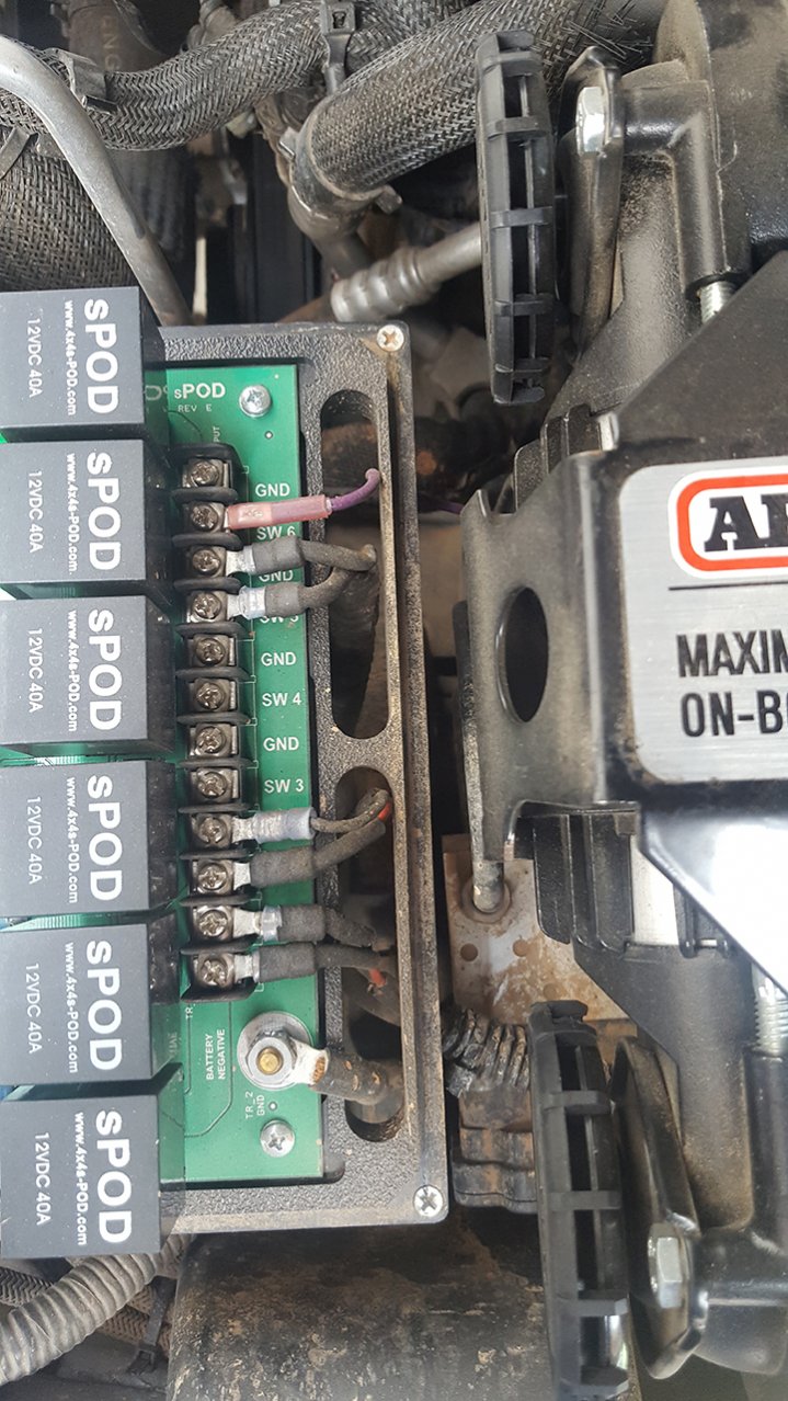

Here are some pics of the J-Wire installed in my Rig. Connected to the 6th switch positive terminal. It works great.

I believe it's grounded through the bigger wires that are on the other harness. Since the sPod is also grounded, to turn on the compressor all that is needed is power on the red wire of the pressure switch from the isolation switch. This is what the J-Wire does in eccense. If wanted, I can include a ground wire but it is not needed.
