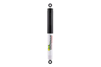

What are the differences in the rear suspension ? I have a 2011 qx56 and the iron man shocks don’t list the 2011. I’ve spoken to them and they couldn’t tell me if they would work
toastyjosh
Yhis is what I found on there site when I put in a 2011 qx56
Check out these guys, do some measurements, take some pic and call them.
