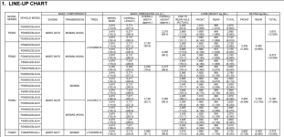

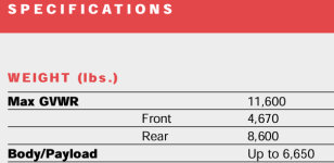

You might want to request a photo of the data plate for the TV Van as Canters had/have GVWR ratings both above 14k and under 14k
2008-2010 Body Builder Manual
earlier ones had an even lower GVWR
1998 sales brochure
