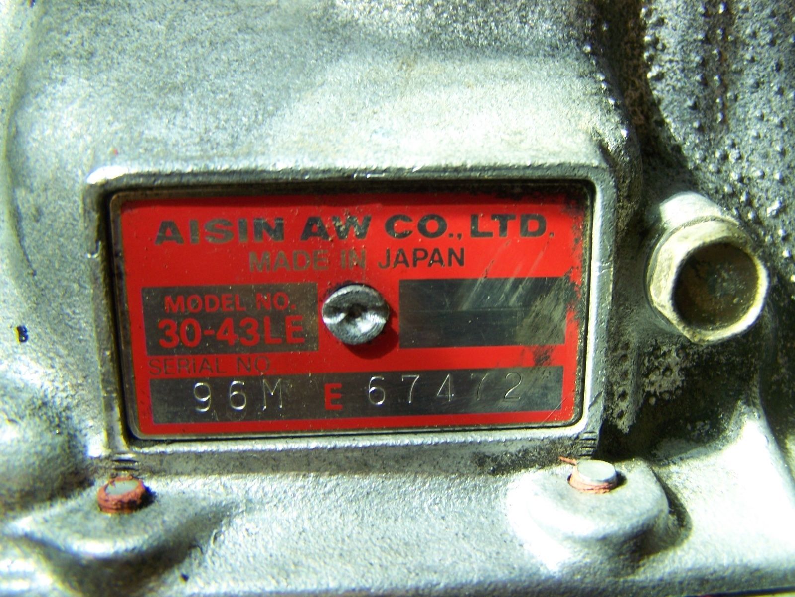

A little known fact is that Mitsubishi ALSO used the Aisin Warner AW4 in the '90s Montero and Montero Sport. For the Montero Sport, the relevant years are '97 and '98 and is known as the AW3. Unfortunately, in '99 Mitsu changed to a completely different transmission - which is neither all that great for off-road apparently nor even remotely close to the AW4 so no 'easy' modifications. The model/serial tag attached to the transmission from a 1997 Montero Sport is shown below.
1997 Mitsubishi Montero Sport AW4 Model Tag

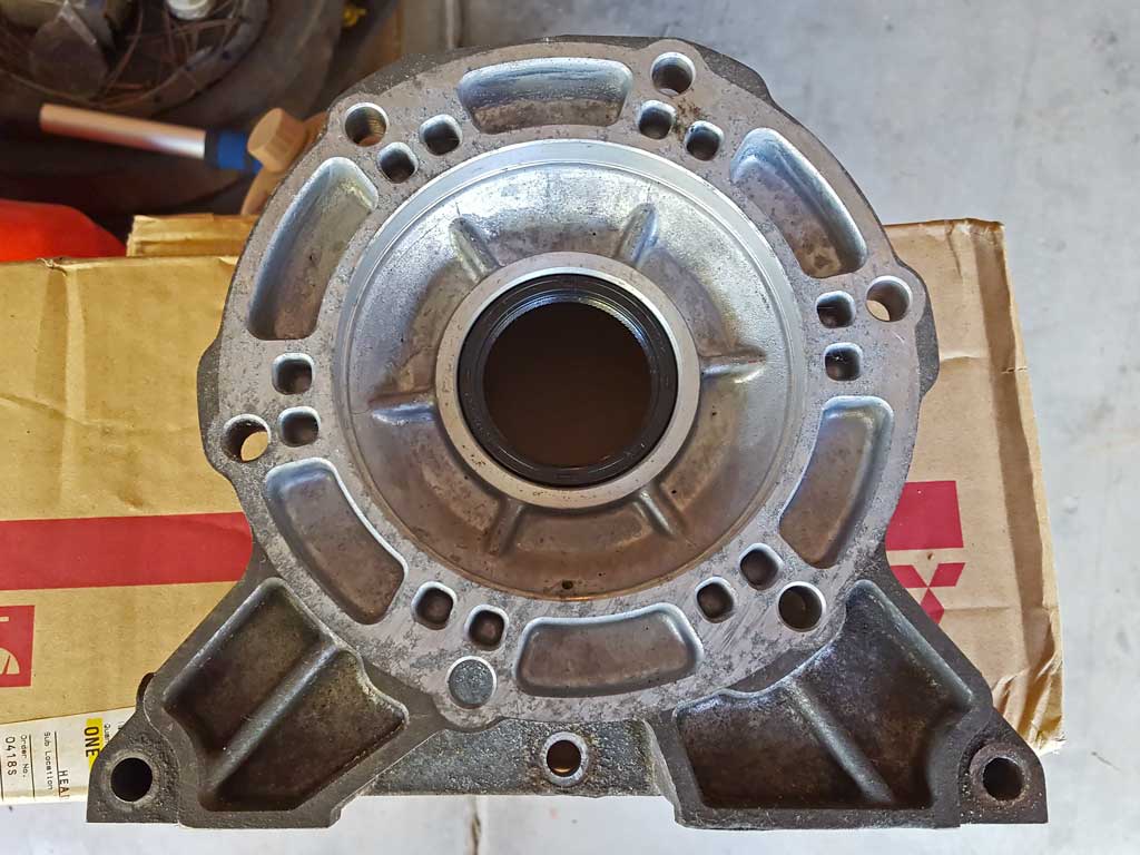

The important thing to note here is that the AW4 is 'modular'. The bell housings as well as the rear adapter housings are removable. This allowed manufacturers to easily adapt the Aisin Warner transmission to their engines and transfer cases. Shown below is complete Mitsubishi 'AW4' with the removable bell housing on the right and the adapter housing for the Mitsu t-case on the left.

Like the Toyota, the Mitsu AW4 uses a different rear adapter housing and output shaft to allow the manufacturers to bolt their transfer cases to the transmission. These two pieces are, as noted above, interchangeable. Shown below is the Jeep Cherokee XJ adapter housing and the Jeep Cherokee XJ 23-spline output shaft used to allow Chrysler/Jeep to bolt the NP transfer cases to the AW4 A/T.
Jeep XJ Cherokee AW4 Adapter Housing - Transmission Side
Jeep Cherokee XJ AW4 Adapter Housing - Transfer Case Side
Jeep XJ Cherokee AW4 23 Spline Tailshaft
Yes, you probably guessed by now that if you replace the adapter housing and output shaft with the appropriate pieces you can bolt a Jeep NP transfer case to your 'Mitsubishi' automatic transmission.
