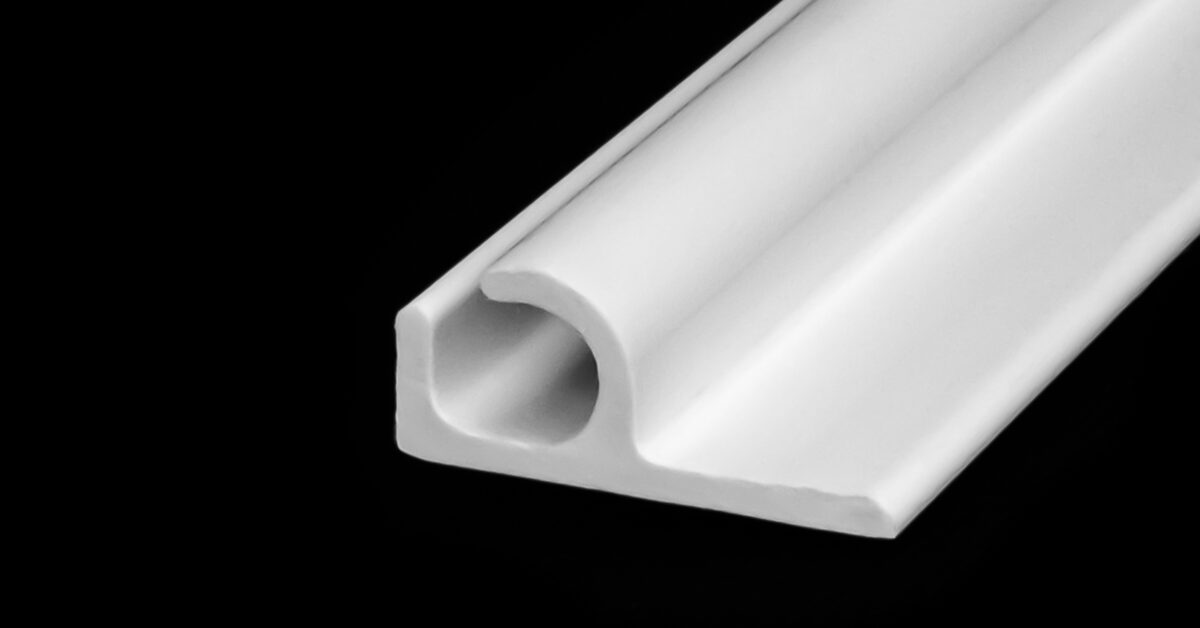

I think a 7' length of "Keder rail" using 3m VHB tape along the top of my hard top will do the trick.
Then sew this onto the edge of a shade awning cloth:
Grommets on the outside corners and a pair of poles.

I got the Keder tracks installed with 3M VHB tape on both sides of the Jeep. I went with the plastic track because it's black vs the silver aluminum. There won't be much stress on the track so the VHB tape should hold up. I sent the sail track material to a tarp maker who is going to make me a 7x8 tarp out of lightweight sil-nylon. I bought a pair of REI awning poles that collapse down pretty small. It was cheaper to buy the tracks and material factory direct than through the sail supply company. Shipping was only $16 for an 8' long box!
