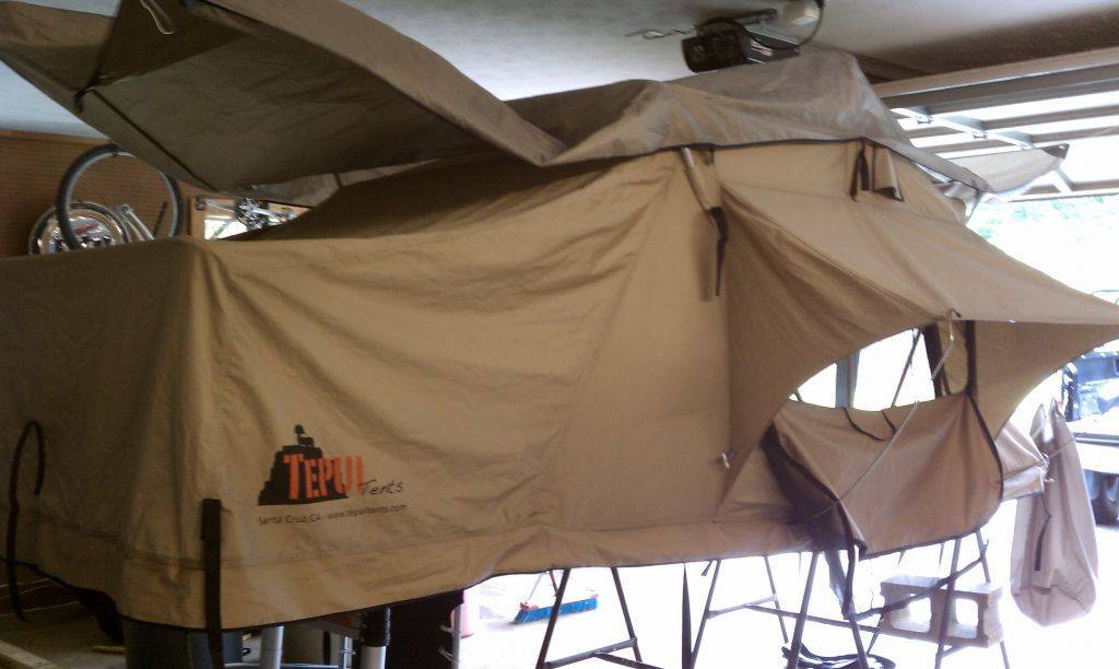

Thanks for everybody's ideas! We got it off and opened it up in the garage with one dehumidifier in the tent and a fan blowing on it from outside. The annex is hanging on the clothesline. It's raining off and on but at least its not wrapped up in a bag mildewing.

I posted a reply way earlier with a pic but it hasn't been approved yet. Thanks guys for all the idea's! We ended up opening it up in the garage. We put a dehumidifier inside it and have a fan blowing on it from the outside. Thanks again for all the replies.
