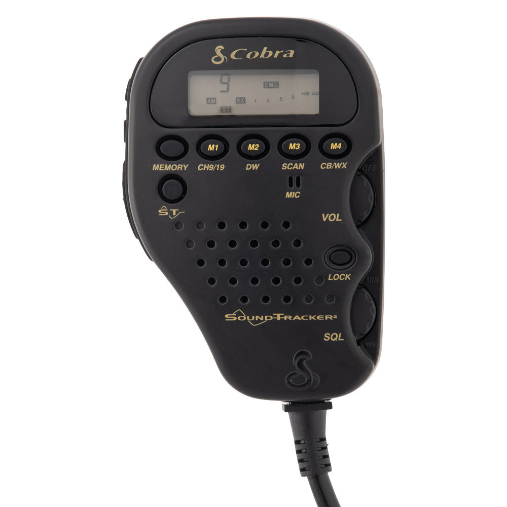

I’m looking at installing a CB (probably the Cobra 75WXST that has all the controls in the handset). Under the driver’s seat would be the ideal location, as I can tuck the handset in there as well and then place it in the cup holder while in use. The power seat fuse is a 30A circuit, does anyone see an issue with tapping into that and adding a smaller inline fuse to run the CB? Basically wondering if the seat has a sensitive ECU that might be messed up, I don’t have the memory seats. I’d like the ability to use the CB with the ignition off also, not for any extended period, but to check the weather briefly, etc, which this would allow.

CB would likely work fine under there, and the Cobra is a decent enough unit but I'd suggest if you are going to invest in comms-go GMRS, less antenna with better range for most, better clarity, small form factor (the Midland 275 is basically the GMRS version of the 75WXST)

I’ve been reading up on the radio stuff, as I’m quite ignorant. My uses would be #1: communicating with another vehicle I’m running trails with, very short range stuff. Maybe a couple hundred yards apart, up to half a mile or so if someone takes a wrong turn. #2: being able to signal for help if required, there are a lot of hunters/guys just riding around the woods up here and I’d imagine CB is still the most common in my area. #3: pairing it with a handheld unit in the event that someone needs to walk out to find help. This is probably unlikely, but would be nice to have, especially since I might buy a handheld anyways in the event that a vehicle in our group doesn’t have a radio.

I will post some pics when I get to the CB install, I’m still doing research at this point. I agree that the GMRS is a better product, but unfortunately with radios, you need someone to talk TO, and I’m fairly certain that CB is still king around here. This is the unit I’m looking at, there is a plastic cover under the driver’s seat with plenty of room behind it as well as a power source. I wouldn’t hard mount the handset anywhere, I would just set it in the cup holder while in use.
