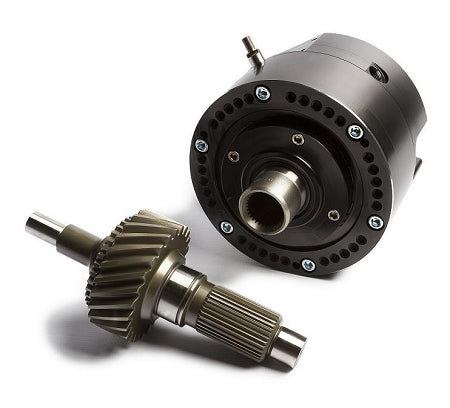

If your TC is one of the alloy chain-drive ones ubiquitous the last 20-25 years, it’s ~2.7:1. “Black box underdrive” is a short ~6” w/adapter gearbox that goes between transmission and transfer case. It’s only for trans/TC up to 350/3500 size vehicles. With a symmetric 6 bolt pattern between trans and TC. The 450/550 vehicles use a 8 bolt pattern.
What’s your vehicle?
If you have a F350, consider something like
Low range 1.96, 2.7 and about 5.33
A couple of other outfits do this.

I'm not aware of locking diffs...would be great to find a proven front/rear system designed for 550/5500: anyone out there doing this? Those tires appear to be Goodyear G275 335/80r20. Looking at the specs for those tires I have to wonder what newer/longer ER's weigh, especially the load on rear axle. The carbon fiber LTi is reportedly lighter than older models. I also note the speed rating is higher and ply rating is lower on the G275 than the MPT81. I seem to recall reading that Continental is revamping the MPT81 but don't have a link. Numerous folks using the G275 say that it is excellent for (US-made, modified chassis-truck camper level) offroad pursuits.
Super late reply. Missed your post somehow. There is no proper locker for the Dana S110 rear but it is LSD. The front is a wide track Super 60. Mine has 5.38 gears and a Yukon front locker. 2001 F450 converted to 2006 suspension and axles. Very capable.
I am coming out of the past, but missed this before. Yes, it’s a BW 1356 with about a 2.7 low ratio.
The chassis is an E450 so that’s a bit small. Thanks for laying it out for me, though.
