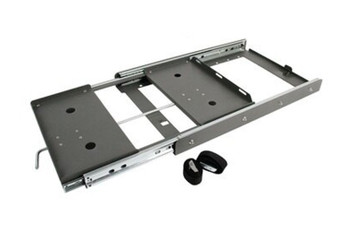

It seems that most of the fridge slides I'm seeing are several inches wider than necessary to accommodate the 26" x 18" footprint of the CFX50. (this is including the now discontinued Dometic slide). The DFG Offroad unit looks like it might be nice, but they don't post the dimensions and its not clear to me whether it locks.
To me "best" means some combination of the following:
  1. Minimizes wasted space with the Dometic CFX50 (26" x 18" footprint)
  2. Locks closed without rattling
  3. Locks in the extended position
  4. Relatively light weight (no excessive plate steel or angle iron)
I'm tempted to build my own, but I already have a list of weekend projects waiting for me that is backlogged well into the summer... Plus when I add up the parts (using aluminum channel and 200lb locking slides) it comes out to over $300, so cost savings is not really a factor.
Contenders I've seen so far:
  • Tortuga Offroad XL (too big,. but I like the second slide-out tray)
  • DFG Offroad (don't know dimensions)
  • Dometic slide (still available in a few places, but also a few inches more wide and long than necessary).
Yea, I know - I'm being a perfectionist. But I spent a lot of time on this...

For posterity, I'll post what I've found so far. The ONLY fridge slide I have found that is the "Goldilocks" fit for the Dometic 50 is the DGF unit. The external dimensions are 28-1/4"L x 19-1/2"W x 2"H . Tray dimensions are 26-1/4" L x 18"W. In other words, it is a custom "no wasted space" fit. I'm ordering one today.

Update: I went with the DFG Offroad unit. Based on everything I've seen it is the "best" unit for the criteria I outlined. It is very lightweight (all aluminum & stainless steel slides), uses a proprietary locking mechanism for closed and open positions (different) that work well but are not integrated into the slide, so there is no additional protrusion from the slide), and waste almost ZERO space with the Dometic CFX50. The only thing I have found to complain about is that the rear cross member sticks up just high enough to interfere with the AC cord (for pre-chilling before a trip), and just kisses the DC cord. I plan to clearance both after my current trip. I'm on Day 2 of a trip to Anza Borrego and so far I love this slide.

Last day of the trip (Tierra del Sol expo) and even doing some moderate “rock crawling” and lots of Jeep trails with the cooler packed full it worked beautifully. We had very windy/sandy conditions at times and I can definitely feel some grit in the slide now. Not sure if anyone offers a completely sealed bearing system so perhaps any slide would be susceptible to grit getting in there.
No rattling while off road in some pretty extreme rough washboard and waaaay off-camber Rick climbing.
I still rate this as a great option for a Jeep or other vehicle where you don’t want to waste any space.

Here's a video of it in operation. Things are a bit of a mess, as I was unpacking from the trip. Sorry for the lousy video - I was holding the phone in one hand and fumbling around with the left hand trying to do it. ;-)
And a photo with everything out of the way:
