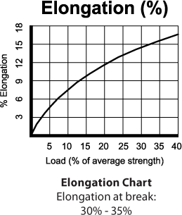

We have an Xterra that weighs around 5300# loaded (no occupants). I'm thinking the 7/8" would be the safer choice, but the 3/4" could work, assuming that number on the product page is a typo. For our weight, 1" seems like it'd be overkill, and would be hard to get much stretch out of it.

But 1" is only another 10 dollars. The jump to 1 and a quarter is a bigger jump.
It's not about saving ten bucks. It's about sizing the rope to the weight of the vehicle so that it actually gets some stretch. For my vehicle weight the 1" size is probably too stiff.
I understand but it says in there a 4 door jeep could be either 7/8 or 1", which an Xterra is similar to and it also says you could go up one for environmental factors so I think the 1" is completely valid option.
